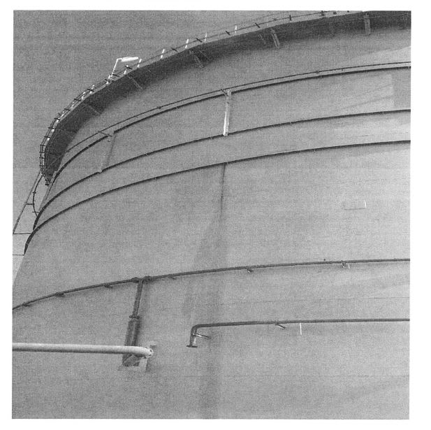

by Visual Inspection, leakage from 5th course of shell has been observed
what is the fast solution online without shutdown as a short term?
What about UPS (Unique polymer system) copy attached ?
Have you been closer to the leak than the picture?
What is the design operating pressure?
What is the ACTUAL operating pressure ?
Is the level of condensate expected to reach that level in proper operation?
I'd want to confirm (*) the leakage is not the symptom of a larger problem.

The design operating pressure is 5 bar, and the actual one is ranging from 0.5 to 2 bar
Yes the cond level expected to reach in proper operation
Last in service inspection in current year.
Last out service API 653 inspection at 2011
That's a straight line....indicative of a vertical shell weld that might be failing. I'm with Tmoose....get a closer look and look for bigger problem than a leak.
My concern would not be that this leaks but that if the vertical seam is compromised you have a potential disaster on your hands. I'd immediately lower the level in the tank to below that entire vert and then get up close and personal with NDE to see what's going on.

What is the service? Seems gasoline from the attached document. Is it a floating roof tank?
I understand the problem from the management's point of view, in service inspection in current year could not detect any thickness loss as the location is not beside the stairs and the next M&I could be another 4 to 6 years away.
Surely you have lowered the level below the 5th course.
You have to operate the tank at that level and go for shell partial replacement at the earliest if it is a fixed roof tank.
As a temporary measure, you can go ahead with the proposed action (unique polymer system).
If its a floating roof tank, then you have lot of options to choose from.

But the repair is done (Cold repair by belzona)
Find the following tank after repairing:
Dear Yahya Omar,
You did the right thing. How many years after is the next turn-around? Do not extend that, rather take the tank for scheduled M&I earlier, if possible.
