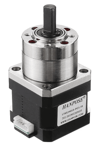

I have an engineering challenge.
I am in the process of designing a pick and place machine with a table moving in the X and Y direction.
For the Z-direction, a gripper is placed on a moving arm above the table.
For speed and cycle time purposes, the table is driven by a rack-and-pinion system. Such as:
The drives that are used are NEMA17 stepper motors without gearboxes for X and Y. The Z-drive has a gearbox on it.
However: If the system is powered-down, The table needs to be stabilized so that it cannot move around anymore. Also, the gripper-arm must be held in position when the power is switched off.
I have been trying to find an easy electrical system to lock this in place, but I have been unable to find anything useful up until now.

Thanks for all the replies.
The reason I did not use NEMA17 motors with brakes is that I use a geared motor for the Z-drive (See picture below) A brake cannot be added. I was hoping on finding a simple solution that could be used on all drives.
The thing that I am exploring right now is to create a simple brake system myself for this. Use spring-load to generate friction between the moving part and the static part (rack).
The only thing that I cannot get my head around is to find an electrical actuator that is able to supply approximately 5 [N] of force with a stroke of +/- 5[mm] The simple types of solenoids (2nd picture in 1st post), they generate the force, but only at the end of their stroke and they cannot be activated 100% of the time.
If you happen to know of any principle / type of actuator to use for this, please let me know! Thanks in advance!
Motor brakes usually replace the end cap of the motor opposite the drive end, or you can get a double ended motor. This is the correct solution for your application and you should adapt your application to allow for it.
Yes and even if Hanpose do not have that combination, gearbox and brake I am sure they can fix it.

Apart from all electrical solution so far proposed, if you have access to air pressure then a single acting (Spring return) cylinder, of suitable diameter and stroke, powered by a single solenoid valve would do the job of positive locking.
Power fails, valve resets and spring pushes the piston rod forward to engage positively with the table or gripper arm. Some designing has to be done but that's not a hard job.
Thanks for all the feedback! I did not find the nice NEMA17 motors with integrated brake myself as an assembled piece. The pneumatic option is the only option with an actuator that is feasible, I think, besides the on-motor brake.
