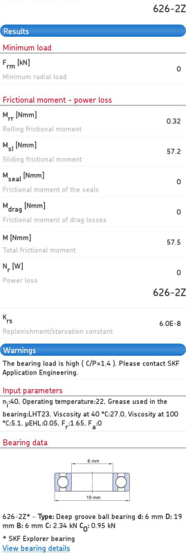

I have a shaft with a radial load of 2300 N. I have two deep groove ball bearings on the shaft, pressed into rotating members. Is there an equation to calculate the amount of radial load the bearings absorb? I'm trying to figure out how much torque resistance there would be on the shaft's rotation. The shaft rotates with the long members. The drawing shown isn't fully representative of the system, but it gives you an idea.
I should've mentioned this, but didn't think to. The calculator can be a little finicky when it comes to low rotational speeds, particularly when the speed is unknown. Since the members will be turned by hand, we're looking at something like 30-50 RPM.
The SKF calculator says no loss due to seals. I'm assuming because there is no axial load.

I was unable to find any equations that worked with the low rotating speeds. I suspect it's because true rolling friction is less predictable. I used the SKF calculation anyway; I have no idea whether the actual torque was higher or lower than expected, but the equipment functions well for us.

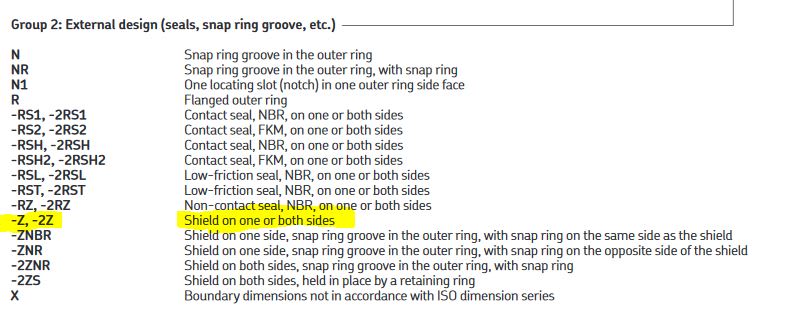

Your bearing has no seal losses because it has no seals (-2Z suffix denotes non-contact shields)
