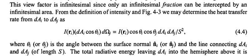

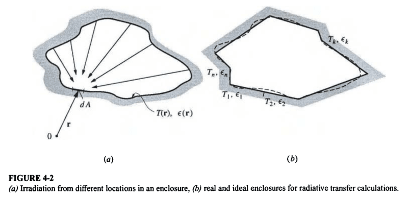

The usual approach is to mathematically describe the view factor and integrate over the supposed field of view. The following is from Radiative Heat Transfer by Modest. Note the cosine terms, which basically zero out the radiative transfer for incidence angles at 90 deg from the normal of the receiving surface differential area. Anything below that angle is essentially invisible to that differential area
