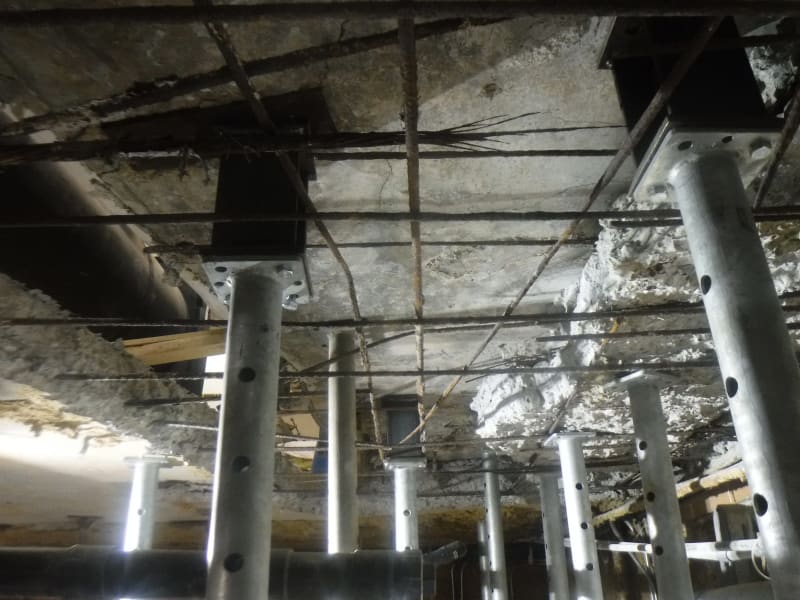

We did a project (just before COVID hit last year) to a 3rd floor mechanical slab that supported a large boiler for producing steam to the hotel's laundry.
Near 40 year old, unbonded PT slab. Did not have a protective membrane for the first few decades of its if life. Fast-forward...and after repeated water-softening (brine, so high Cl- content) that overflowed (twice daily when the system flushed/cleaned itself) due to floor drains that were inadequate, and the unbonded PT slab had no chance. Repeated repair of the past 20 years (by others) were ineffective.
We had to support the operating 30,000lb boiler on temporary shoring and did full-depth slab replacement. It was easy to de-stress the PT - corrosion did that for us. It had a 7' cantilever (on the RHS of photo) that I have no idea how it stayed standing.
MORAL: provide a plinth/housekeeping slab, but also protect the supporting slab too, because mechanical rooms can be nasty areas, and some owner's neglect the required maintenance.

Ingenuity: What was the temp support protocol? I don't see any anchorage points so I assume you didn't hang the pad. Did you core for prop install from below and cast them into the slab / cutting base off after (or same but slide onto cast in blocks)?

Temporary re-shoring of the structural slabs from underside of L3 to loading dock using JASCO Hi-Lite frames:

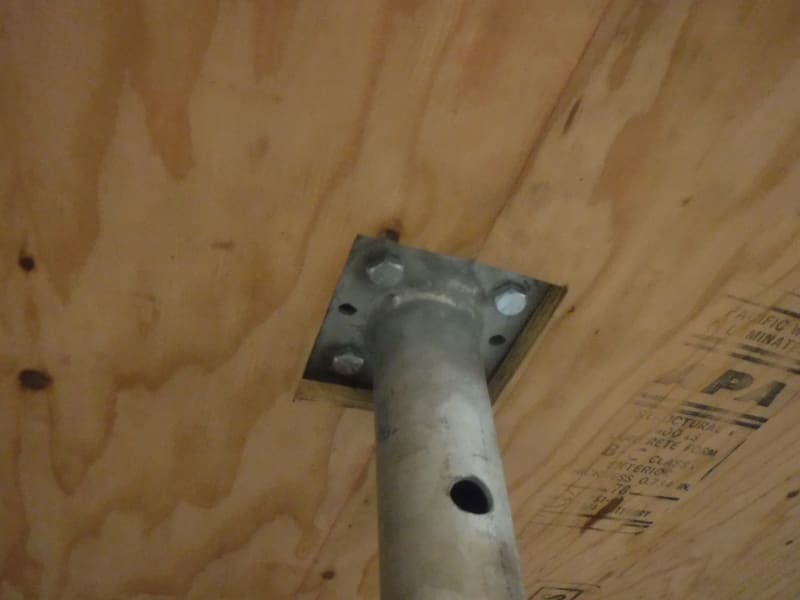

For temporary support for the boiler I purchased some W4 stock and cut into 7" lengths and welded top and bottom 1/2" thick plate (8" slab thickness) with tapped holes to the bottom plates that matched holes centers to the DB-350 shoring posts. The W4's were sacrificial 'stubs' buried into the concrete.
Given the obstacles below (and a fully functioning electrical room), we stick-framed the slab formwork, and cut around the shoring stubs for ease of removal.
Would you believe, it. we finished the project then the hotel said, given COVID etc, they would be shutting down the hotel and fully refurbishing the mechanical room. The old boiler got replaced with a modern steam boiler at half the size and weight, on a new housekeeping slab.

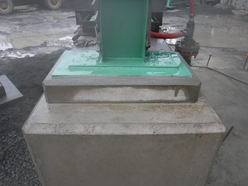

I really admire pad workmanship on the 2nd picture, look how those 45 degree chamfers meet at the corner. Anyone knows what kind of formwork was used?

Rabit: Those chamfers are just 3/4" cant strip by looks of it. Can get them from any formwork or roofing supplier (see here for example). That'll go on to some formply. Not much to it other than the dude installing them knowing how to cut the cant at the corner (it definitely does take practice to make all the compound cuts).
Looks like MDO (medium dense overlay) formply with 1" pine chamfer strip.
If you want really nice edges and chamfer corners use steel forms and magnetic chamfer strip.
In the above photo, the base plate grouting used steel forms and magnetic chamfer, and the pedestal was used MDO ply with hand-cut pine chamfer. Most times the owner's only want to pay for wood form finish.
