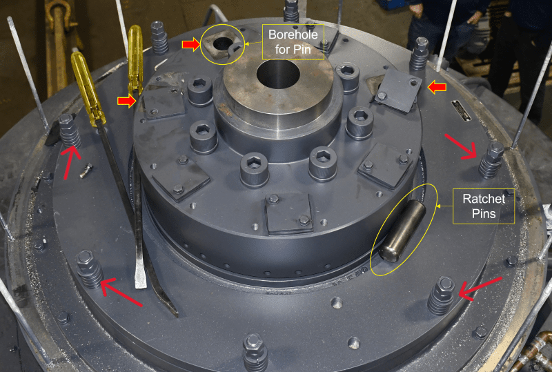

We own 4 of these motors described below. The motors are tripping due to high vibration. Last week we found that the ratchet (NIDEC's design) is coming apart. This ratchet design uses pins to lock the shaft in place to prevent it from backspin.
1. Has anyone experienced this failure mode before where pins are pushed out of their boreholes (Image with red arrows and some notes)?
2. Also, if you take a closer look at the unedited image, there is a considerable amount of shavings in the pockets that are supposed to hold the ratchet pins when reversing. The pins will slide in the forward direction until they are held above the resting plate (the one with the pockets) until it coasts down and the pins slide down to engage. The wear damage is from only 9 months of intermittent operation (2 times per day, approx. 6 hours of operation). Has anyone experienced this level of wear?
3. The bottom plate is cast, shouldn't it be from the same material as pins or stronger?

We had some problems with sliding pin anti-reverse rotation mechanisms on vertical motors, although a slightly different style and a different problem. It was discussed a lot of details (and good input from others) here: thread404-478475
My lessons from that (not necessarily relevant to you): The pins can see a lot of force when they engage during reverse rotation. And the combination of number of pins and number of ratchet steps determines how long an arc reverse rotation can occur before they engage (longer arc means more time to accelerate in reverse direction and therefore more momentum/impulse to absorb when they finally do contact). Also counting on pins to share the load during "simulateous" contact of multiple pins is a dubious proposition since it would require ridiculously tight geometric tolerances to actually achieve simultaneous contact and load sharing.

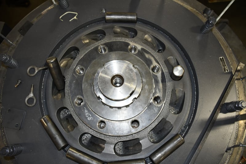

For your situation, were the pin covers found that way partially dislodged and shown in 2nd photos? And if pin covers were in their proper position (rather than out of position) would they have low enough clearance to the top of the pin to prevent pin from dislodging? If both yes, then first guess maybe the pin cover needs to be held more securely in order to be able to absorb the force from stopping reverse rotation? (the other factors about load sharing and number of pins / steps may play a role as well). Maybe that is all obvious or maybe off base, I'm not sure...
EDIT - And how many steps are there on the ratchet plate below those pins (that plays into the combination which determines maxixumum reverse arc between pins dropping and pins making contact).
We didn't see shavings but we did conclude we needed to start using lubricant on the pins to prevent them from sticking. Were you able to determine which portion which which component was producing the shavings?
electricpete, it was your older thread what motivated me to ask in this forum. I looked at the ratchet in that thread and it intrigue me. Let me start by answering your questions.
1. For your situation, were the pin covers found that way partially dislodged?
Yes, they were found as you see them. The only thing I believe can do that is the pin pushing from inside. Fatigue must have loosened those covers.
2. If pin covers were in their proper position, do they have low enough clearance to the top of the pin to prevent pin dislodging?
By the looks of it, they do. Pins are approx. 6 inches long. When the pin is in the top position of the pocket, the space is approximately 1 inch. When the pin is inside the pocket, the space is approx. 3 inches.
3. If both yes, then first guess maybe the pin cover needs to be held more securely in order to be able to absorb the force from stopping reverse rotation?
I agree but again, the OEM claims this never happened to them. They also claim that their motor frame is well established (15+ yrs). I have my doubts of course. But let's say they are correct; it must have been they changed something in their design OR this is a problem of workmanship. Currently, the 4 motors are new and two failed in the same fashion. The other two motors are not commissioned yet.​

Did you notice the bent and broken bolts for the covers? The pins are impacting the covers hard. This is not a fatigue problem.

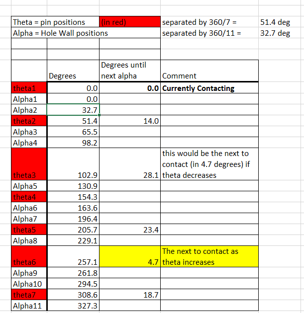

I counted 7 pins, but 11 holes in the bottom plate.
How does that work? only one pin ever engages?
The filings I think come from where the pins are making their own groove in the rather vicious taper out of the hole. You can see where the pins have created a semi circular groove at the top of the ratchet hole.
So what was the failure exactly? One pin had come out and hence the system was unbalanced?

Thank you everyone for your help in brainstorming this failure mode. You should know that for years I have monitored forums similar to this but never posted a question. I find it fascinating and helpful to discuss and brainstorm with engineering colleagues. Again, thank you all.
TugboatEng (Marine/Ocean): There is no evidence to suggest that the pins pushed through the caps from one single blow to the cap. That would have left behind damage visible in the threads, the bores and the fasteners (by elongation of some form). However, in that is not the case. It is more likely than not that the fasteners came lose because they were never properly preloaded. That will qualify this mechanism as fatigue. Once the plate was able to move, the impact of the pin would have exerted a force for which the fastener was not designed, bending the fastener with every impact. Again, one of the two fasteners must have come completely lose first, then the second fasteners would have loaded by the level arm advantage that the plate has over the only fastener still in place.
LittleInch (Petroleum): You are correct, when you lose one pin, the ratchet becomes unbalanced which is reflecting as a 1.08ips vibration affecting the entire motor. Each pin weights 2.64lbs. Almost forget, according to OEM, the ratio of pins to rams is to ensure that one pin locks in place. What I found yesterday is that only one pin engages, period.

Yes it would result in only one pin engaging. I believe the objective of that configuration is to minimize the momentum at time of impact by minimizing the worst case possible arc the rotor can travel in reverse direction before contacting in order to minimize acceleration time before contacting. With 7 rotating pins and 11 stationary holes, the furthest the rotor can travel between contact points is 4.7 degrees = 360/7/11 (assumes the pins and holes are collapsed to a point for simpler math, and also neglecting pin dropping time for simpler math). in contrast if you had 7 pins and 14 holes, 2 pins would take the load but the arc of reverse rotation could be 25 degrees = 360/14. That's more than 5 times as much 4.7 degree arc of the 7/11 configuration. I believe those 7/11 numbers were intentionally selected in this way to minimize that worst case acceleration arc.

edit, might as well check for any signs that pins are prone to sticking and not dropping. if one pin didn't drop, that means the rotor is traveling faster when the next pin does drop
Those gaskets under the covers for the pins are way too squishy looking to be part of any mechanical connection. Heck, they're way to squishy for any application. I would toss them and use a gasket maker of your choice.
actually, I need to backtrack on something. What makes the pins go up during reverse rotation. it seems to be expected based on the design of the shock absorbers and maybe the pin covers. in our motor, the pin drops during reverse rotation and raises during forward rotation (pushed up by the ramp when started in the forward direction). are the holes that the pins ride within at an angle from vertical? (do you have a photo of them?)

Depending on the clearance, pins sliding in a closed pocket will create pressure at the closed end - exacerbated if there is any lubricant to work as a seal.
The pins should not contact the ratchet plate during normal running. The ramps kick the pins up into their bores and centrifugal force (yes, it's a simplification) holds them there until the speed is lower enough for the pins to drop into the ratchet plate.
