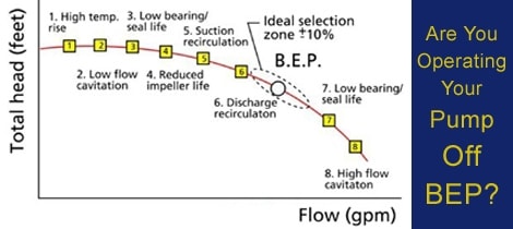

Hi all,
I got a quote of a API 610 pump with an efficiency of 38%. I asked the vendor if there are any pumps with an higher efficiency. They have a pump with an efficiency of 48% at the given rate but it is below 80% of the BEP flow rates.
What would be the problems if the flow rate is below 80% of BEP flow rate?
Thanks!

<80% BEP is a lot on the left so doesn't give you much room for less flow without hitting internal recirculation issues.
On the pother hand there is a lot more flow capacity out of the pump than your rated flow. And better NPSH.
But not all vendors provide good coverage for all flow and head combinations. Sounds like you need to spread the net a bit wider.
Besides the obvious hit on economy of operation

So even if the efficiency of the second pump is higher, but as it is outside of the 80-110% BEP range(69% of BEP), the electricity cost maybe higher?
Why is there suction or discharge recirculation if the flowrates are low?
Definitely will cost to run it. It's important because 150m is a pretty good height. You'll maybe at 3 X your hydraulic power at the power meter.
The pumps impellers want to take more volume than you can give it into the pump.
When you go there with half a glass, the pump would rather fill that glass first. It spills back into suction whatever shortage you arrive with, then it takes it to discharge.

Having said that about 50 odd percent looks about right for that size of pump when I look at other pump suppliers but you seem to be in a strange place where the head you need is high compared to the flow. Max efficient is maybe 65 to 70% so worthwhile chasing different vendors to see if you fall more into their range of pumps.

Often, in actual operation, pumps dont operate at design conditions. Flow may be less than design, or developed head may be much lower. In such cases, a variable speed pump will help to reduce power demand. It may be nice to have a pump with a design flow at higher than 80% of BEP, but to me, is not a must have:- the pump min flow recirculation control loop should kick in when required.

If this is a negligible additional power cost compared to other consumers then just go with it. You just need to make sure the flow can't go much lower than your rated flow without allowing for some sort of recirculation line.
