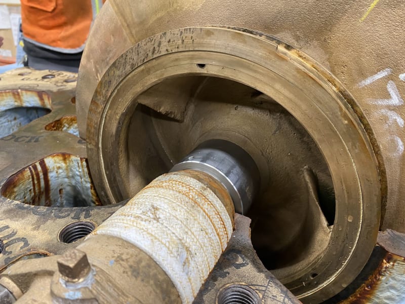

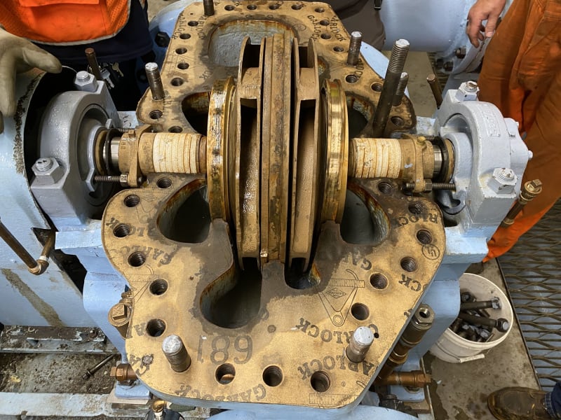

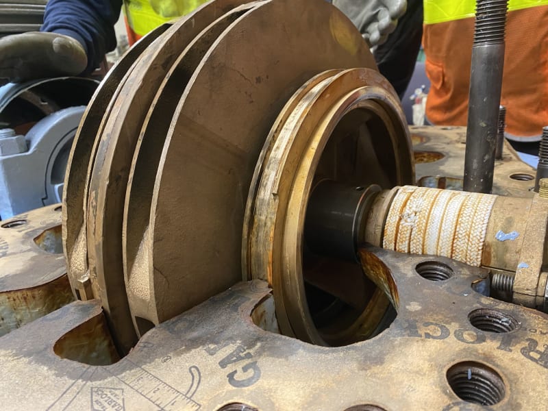

Hello all, I wanted to give an update on this. Pump cover was removed and it was found that the second stage impeller wear ring shifted outward. This coincides with recirculation/cavitation sound we heard and explains the loss of head at shut-off and reduced flow when valve was returned to fully open position. Appears that set screws were not installed on impeller wear ring on second stage which caused wear ring shift during testing at shut-off head. Rotating assembly has been pulled and repairs are underway. Thank you all for the advice. Below are pictures of pump with cover removed.
