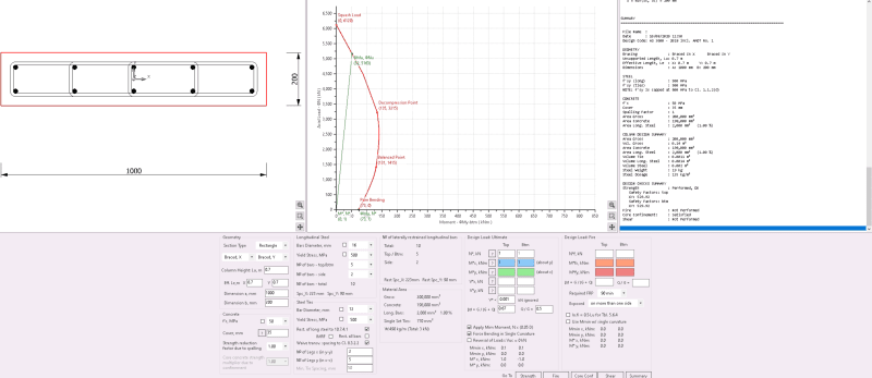

Hi all,
Has anyone used INDUCTA RCC for column design recently (with the AS3600:2018 code incorporated)? I have currently run a few column designs using it and noticed that the decompression point calculation is wrong. Now I just want to confirm if it is actually wrong or if I am missing something. I have compared it to a hand calculation that I performed and to the calculation performed by structural toolkit both cases the results did not match. I would like to know if i should abandon the application.
Thanks!

I've checked the load factors they are all the same. For a 1000x200 (5N16s top and bot) It seems the difference is coming from assumptions each program is making. RCC is assuming a Ku(dn/ds) = 1 while structural toolkit and rapt assume a Ku = 1.379 (dn/ds = 200/145). This is 35mm cover and N12 ties.
I assume RCC is taking ku as 1 to ignore the cover concrete and make the extreme fibre, with 0 strain, at the steel level. This ends up giving less axial capacity but an increase moment capacity.
Conversely, with a ku=1.379, we get an increased axial capacity but a decreased moment capacity.
Which of these two do you guys assume is the most realistic assumption?

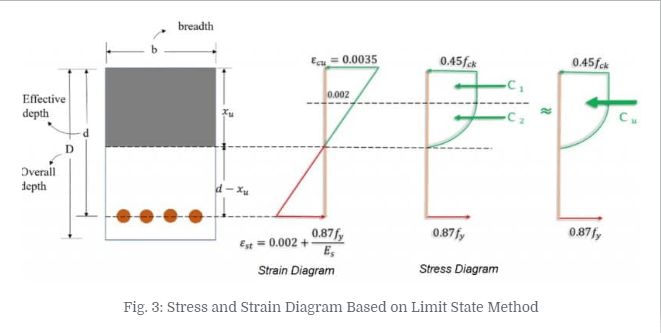

Maybe this will help us stay on the same page/terminology. I think dn is Xu in the sketch below.

So apparently RCC Inducta use a parabolic stress profile but take the point of zero strain at the tensile steel depth.
I have attached my hand calcs that shows results when the 0 strain is at the face of the concrete.
I have attached the RCC output for clarification.
Do you guys think that despite this difference the interaction curve should still be the same as the case of 0 strain at the tensile steel level is a point on the curve.
Thanks.

Maybe try posting a better image of your rcc output as it's virtually unreadable to me to compare anything. Too blurry.

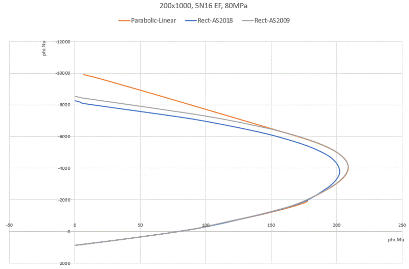

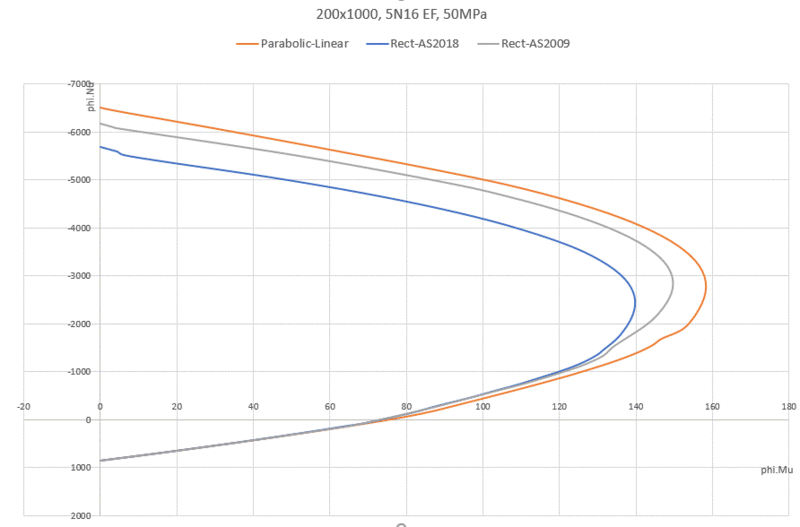

With gamma = .67, the centroid of compression force is at .333d which is the centroid of a triangle of depth d. The actual concrete stress/strain is not a triangle
For high-strength concretes, the EC2 parabolic-linear stress block becomes quite close to a triangle in the part of the curve that's used. In the 80MPa graph below, the departure between the EC2 and the AS3600-2009 'triangular' result is mostly in the part of the interaction curve that isn't used due to minimum eccentricity. Bear in mind that EC2/parabolic-linear isn't perfect, so departure from it isn't necessarily wrong. The rectangular stress blocks are trying to (should try to) match reality, not some other simplification.
