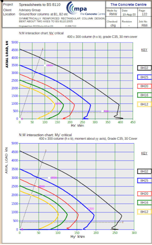

My set of RCC spreadsheets described in the attached... date back about 10 years or so... There are about 40 programs. They are very detailed and very useful, albeit dated. I've used some of the constructions for other sheets that I have written.
Dik
 https://files.engineering.com/getfile.aspx?folder=7ba37122-2e24-48bf-bbe7-4fa467eca9d6&file=RCC_Documents.pdf
Typical part sheet from RCC Concrete Column:
Dik

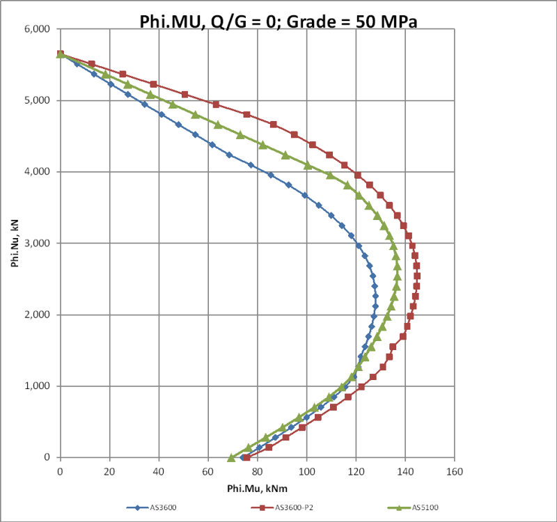

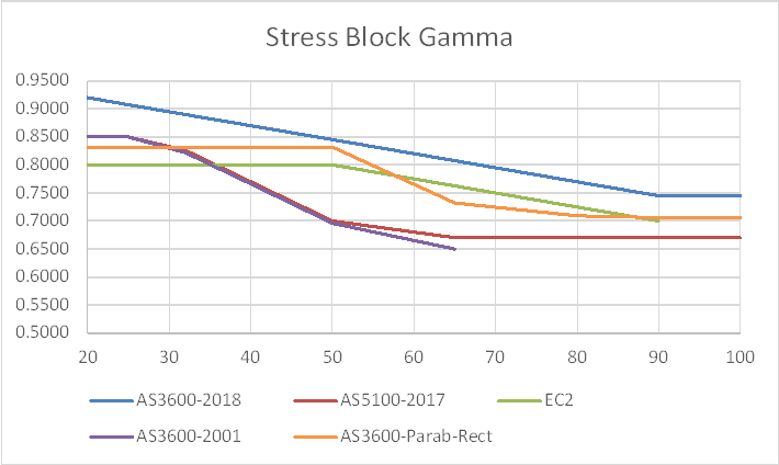

Let's have a look at Australian code and Eurocode factors on the depth of the rectangular stress block:
The orange line (AS3600 Parab-Rect) is my calculation of the rectangular block depth that will have exactly the same centroid as the Eurocode parabolic-rectangular block. Comparing with the other lines:
- The Eurocode 2 rectangular stress block follows the same trend, but is significantly lower up to 50 MPa.
- The AS 3600 2001 and 2009 line (which eventually made it into AS 5100 in 2017) is very close to my line at 32 MPa, but much lower at 50 MPa, and significantly lower right through to 100 MPa.
- The new AS 3600 (2018) line is higher than my line over the full range, but comes close at 50 MPa.
So what effect does all that have?
Comparing my line (red) with the new AS 3600 (blue) and latest AS 5100 (2009 AS 3600) (green)
For 50 MPa with equal reduction factors for a lines:
Increasing the Phi factors for the 2018 and my lines:
So in spite of the increased lever arm, the AS 5100 line gives a smaller bending moment than my line, although significantly more than the new code for mid to high axial loads. Using the higher phi factors in the new code, the new AS 3600 line is close to the old one over most of the range.

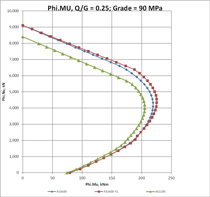

For 90 MPa concrete with equal phi factors:
and increased phi for the latest lines:
With equal phi values, all three curves are very close over the full range, and with the increased phi values the new curves give significantly higher moment capacity, with my line being slightly higher than the code line.

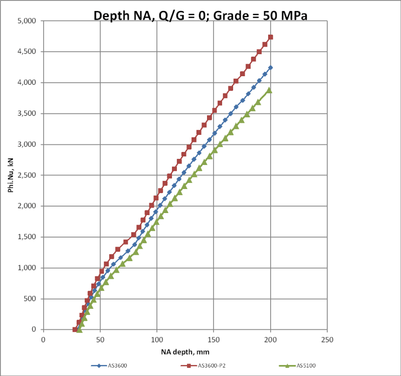

Hi N.K - it's a late post but I thought I might be able to help others with this question.
TL:DR: when validating an axial moment interaction diagram don’t use the decompression point. It’s an imprecise term as defined by AS3600:2018. Instead compare the results to the same neutral depth axis. All calculations to generate a moment-interaction diagram as calculated w.r.t the neutral depth axis. With this calculation you’ll be able to tease out the difference more easily.
The term “Decompression Point” can be a little bit misleading because of the discrepancy you point out. In the Australian Code the decompression is not well defined but the “extreme tensile fibre” refers to the concrete extreme tensile fibre. That is, the decompression point referred to the point on the axial-moment interaction diagram of the stress block spanning from edge to edge.
I think the confusion is due to context. Concrete is assumed to provide no tensile strength in column design so talking about the “concrete extreme tensile fibre” might seem incorrect. Occasionally the steel is assumed to take the tensile force and occasionally then is assumed to be the “extreme tensile fibre” as stated in clause 10.6.2.3 of AS3600.
Truth be told the exact placement of the “Decompression Point” doesn’t actually matter. When validating an axial moment interaction diagram the only thing that matters is the position of the neutral depth axis. So instead of trying to compare decompression points across different programs use the neutral depth axis. Each point on the axial-moment diagram is generated from a given neutral depth axis position on the cross section.
