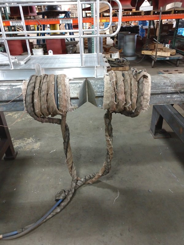

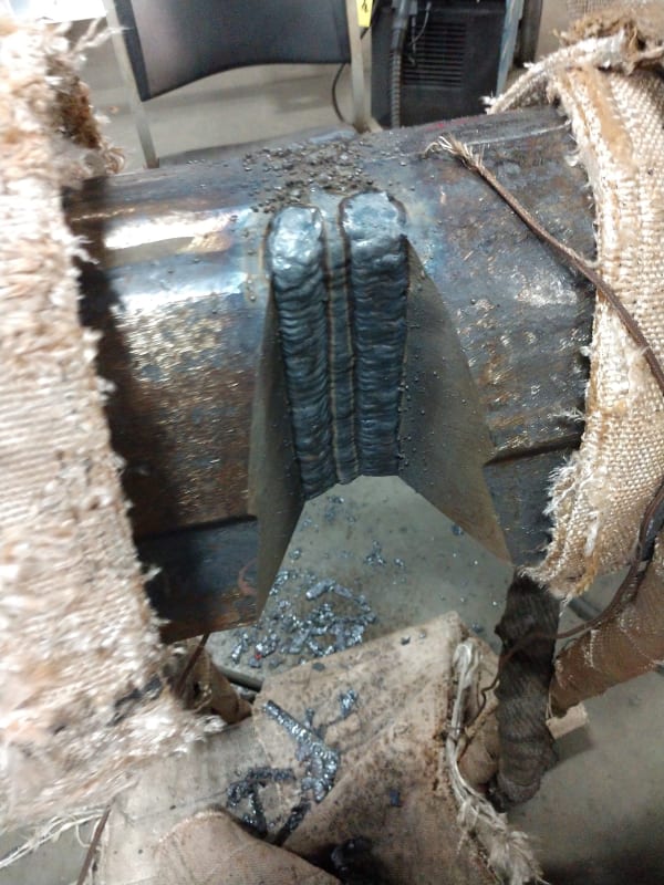

I have a C1Q casting in the shop for another project with AL at .078 which seems to have welded up well.
The Charpy required is 15 Ft-Lb but the test reported 38 Ft-Lb.
The cross section of this item is almost an equilateral triangle with about 9-1/2" legs.
Again the AL for this casting is recorded at 0.078.
No issues at all.
With the induction heater we do have very tight control over the heating and cooling all the way through PWHT.
I find that explanation dubious. I admit that I have never cast that material. I do that quite a bit of experience with similar materials and testing them out of large test coupons. With the Ni, Mo and Mn in that material, a quench and temper heat treat, and only a 75ksi UTS I don't expect any issue meeting 15ft-lbs and -50°F.

While that welding sure looks nice, I wonder why no run on/off plates were used?
