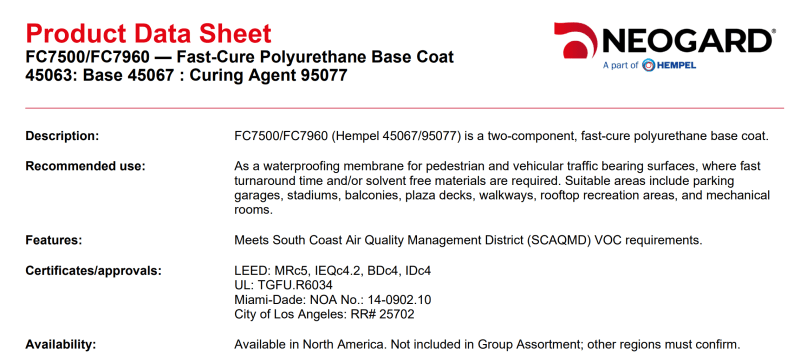

I also spec'd out a neogard pedestrian traffic coating membrane on the concrete. Not sure if they will use it. They did not submit shop drawings for anything, even though I asked them 10 times, and my drawings state that they must be provided for my review/approval or I won't certify the structure.
Brad: Were you referring to a traffic membrane?

Ben, yes I would expect a finish of some sort. It is unlikely you will have a crack free cure, and the communication here does not sound stellar. Some owners are of the opinion that crack free concrete is the norm, and that is not the case.
I assume they were able to roll the C section to the radius specified or they cut it and re-welded as needed to make the curve. This might have been a case not to have a closure angle. It would be easy enough to build a wood closure for the straight segments and the curve. It sounds like it is too late for that. If the architect had spec'd a finish I would expect to see a flashing over the joint, and the finish would lap over the flashing. I agree with Pham where the water will go. I expect a gap will appear between the concrete and angle soon after curing, and that will grow as he described.
The coating will help. Hopefully it will wrap over the edge, but I'm not sure how that product might adhere to the steel. Might need a sealant in the shrinkage gap.
