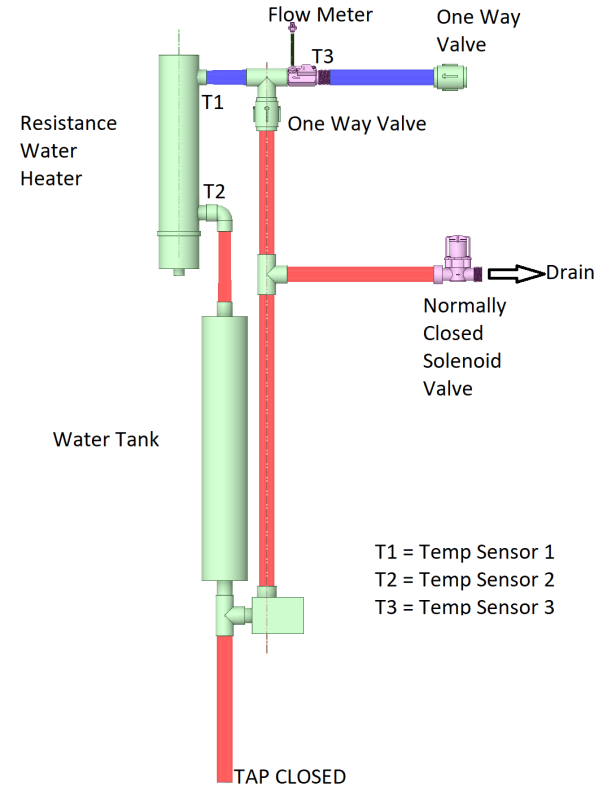

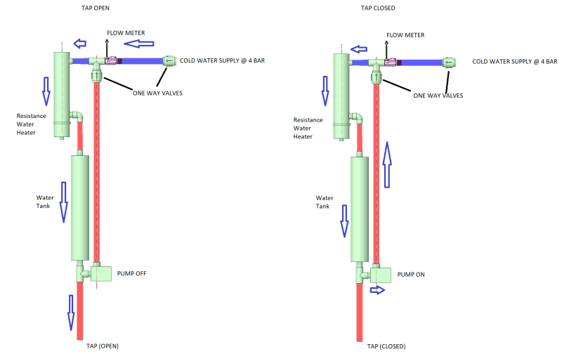

I have posted about this system before, but not specifically the problem i am posting about now.
We have a small instant water heater that has a small water thank (1 litre) attached to it.
The water heater is has a volume of about 0.5 litres.
Its for a very specific application.
When we need to use the warm (not hot max 40C) from this system, we press a button that starts a pre-heat cycle where the water heater comes on and a small pump starts, and heats all the water in the water tank and the water heater to 40C.
There are temp sensors to cut the power off to the water heater when ready.
This is the schematic of our system that i have posted before when asking about where to position the flow sensor:

It needs an expansion chamber. Typical water heaters allow expansion back into the supply line but that path is blocked off here. There should also be a pressure relief valve with the check valves.
the diagram is a simplification of the system. the water tank and water heater are not directly connected. There are other components in between.
the pump circulates the water everywhere in the system
Convection will not circulate the water quickly enough for our needs.
If it were possible to just have a larger tank where the heating element was - i would have done that - removing the problem is always better than fixing the problem.

In standby, the water in the system will be at whatever the network water temperature is (between 7-22 C depending on the time of year) [There will be some warming based on room temperature depending on how long the system is left in standby mode].
The system has a preheat mode that is entered into while the tap is closed.
This means that the approx. 3 litres of water in the system was heated to the target temp which was approx. 43C at the time of the pumps failure.
There would have been a rise in pressure in the closed system as the temperate would have risen by approx. 20 C.
As it has been pointed out, there is a one way valve preventing some of the pressure being relived into the pipework.

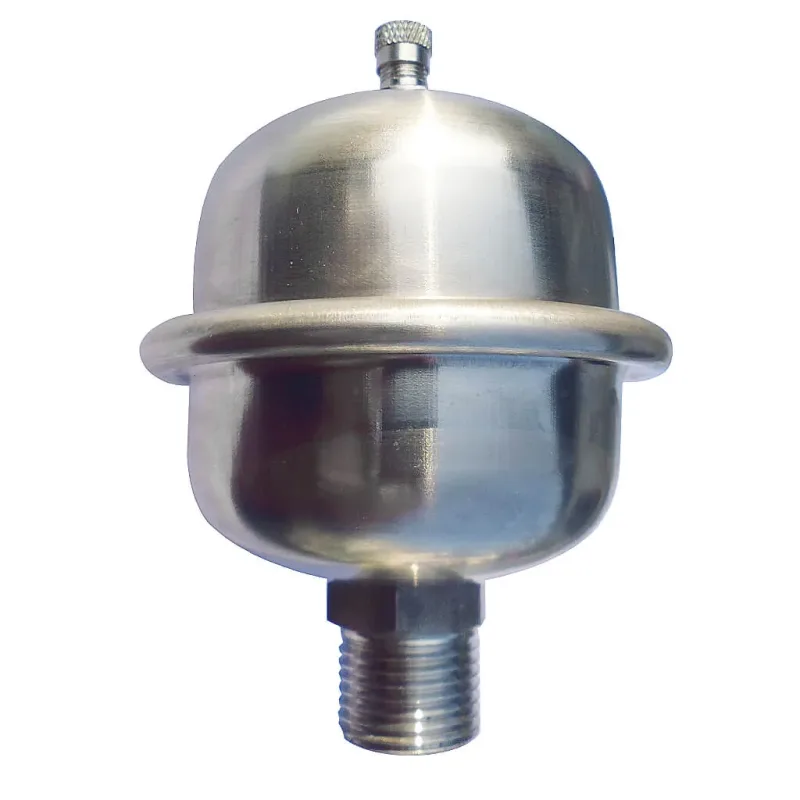

I think 3DDave is right about needing a small expansion vessel. With a shut-in section subject to temperature changes, you ought to have a relief valve somewhere downstream of the inlet one-way valve as well.

I will look into a small expansion vessel

In the circuit, there is a normally closed solenoid valve that connects directly to the drain.
It would be possible to open it momentarily [every few degree temperature rise] to relieve the pressure.

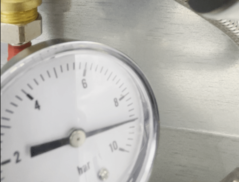

We ran the test this morning.
We increased the temp in the closed system from 20 C to 40 C.
There was a maximum 0.2 bar rise in pressure.
my best guess is that the flexible pipes in our system absorbed the expansion.
This is a Video of the test. At 1 min 37 sec we open the tap and the pressure drops to 2.4 bar.
The only unusual factor we have now at the time of the pump failure was that the water temperature increased to 56C instead of the usual maximum of 40C.
thank-you to everyone who has contributed to this thread.
we ran the pressure test again, and it hit 9-bar [an increase of 6-bar]:
we must have not set up the pressure gauges properly in the first test that did not show a pressure rise
An expansion vessel & release valve should solve this issue as recommended.
The water in the system was about 21 C before the heating element as turned on.
This is the video of the test.
When the video starts, the pressure is already 3.7 bar from the 3-bar that was the pressure before heating started.
We then warm the water to 43 C
The pressure peaks at 9-bar at around 3 min 18 seconds
The pressure then drops off (the temp of the water in the system is maintained but not increased.
After 16 minutes, the pressure has dropped back to 6.4 bar
The tap remained closed thoguhtout.
I would not have found this without your help.
It is very much appreciated.

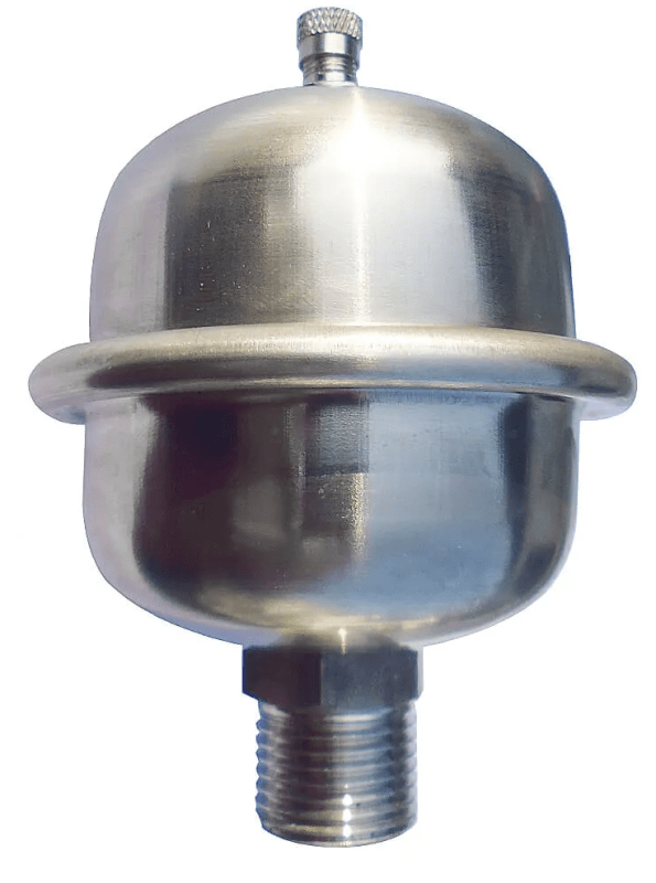

the mini expansion vessel has solved the issue

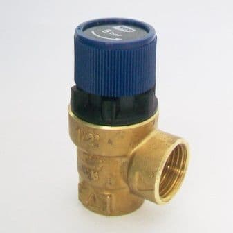

We are also installing a pressure release valve.
I would prefer to just install the pressure release valve and not the pressure vessel.
is it advisable?

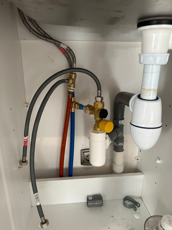

In France i see a lot of instant water heaters that only have the pressure release valve to manage excess pressure in the system:
Can i use a standard 5 bar pressure release valve that i can easily plumb into my system:
my system has access to the waste pipes.

reading this again I think you already have the answers.
apart from 15th Oct "Problem with a relief valve is that it now needs a drain...." compared to today "my system has access to the waste pipes."
as Zuesfaber says "The expansion vessel will prevent the relief from lifting all the time and save you wondering when it will eventually fail to reseat."
These little relief valves are not intended to work regularly and after a few operations will not reseat and drip continuously or just fail. Also your set point needs to be at least 25% higher than your highest normal operating pressure to prevent weeping.
Probably more so your pressure will vary a lot more than using an expansion vessel.
Not to mention finally "the mini expansion vessel has solved the issue" If it ain't broke don't fix it comes to mind....
