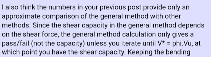

That expectation needs to be tempered by the fact that shear capacity is no longer independent of the loading. The current (MCFT) code can give you 2000 kN capacity on paper, but is subject to the fine print that 2000 kN is the capacity only as long as you never try to use it. If you don't iterate, all you've got is a pass/fail result and not a true capacity.

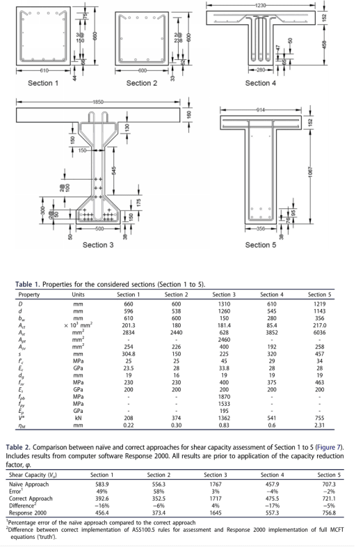

Maybe there's more going on. The results for Cross Section 2 don't make sense to me at first glance. Using V*=374, the authors apparently got Vu=556.3. It's not clear whether they're iterating to make V* match Vu or match phi.Vu but, in either case, shouldn't the iterated capacity be more than the trial V*? They get it going down substantially.
If they were matching phi.Vu (which is the right way IMO), V*=374 resulted in phi.Vu=389. They almost match already. Iteration should do little.

Load rating of shear without the use of the proposed approach is useful as the rating can give an indication of relative shear carrying capacity of different bridges in the network for the same rating vehicle. The rating conforms to MCFT. Load rating by the modified approach using V[sub]u[/sub](approach) and V*(AS 5100.7) does not conform to MCFT so is not suitable to use for the purpose stated in the first sentence.
Since MCFT uses strength that is a function of several load effects and many of the equations used have non-linear terms, care must be taken in coming up with a procedure for load rating and how to use the information obtained. See the comment from Holt et al about taking care in using load rating results.

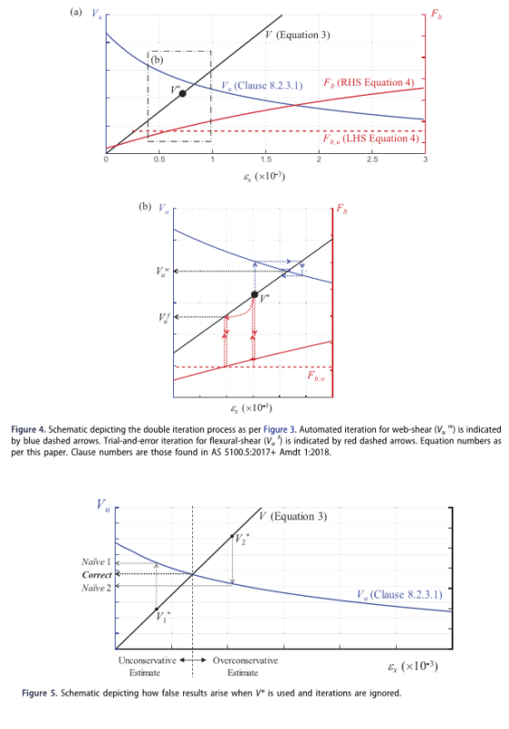

See Figure 5 above. Let us assume that there is only two action effects V and M. What does the line represent ?
At the origin. V* (and the corresponding M*) is zero and P=0.
At the point V*[sub]2[/sub], the shear is V*[sub]2.as5100.7[/sub]. The corresponding capacity is Naive2(as5100.7) and the corresponding moment is M*[sub]2.as5100.7[/sub]. I added "as5100.7" to show that these are factored load effects of the full bridge vehicle system, say P[sub]as5100.7[/sub]. The coefficient eta[sub]M[/sub] is calculated as M*[sub]2.as5100.7[/sub]/V*[sub]2.as5100.7[/sub].
After using the assumed loading (which is not an actual loading) and the iterative solution procedure, the ultimate shear capacity is now Correct(proposed). the word "proposed" to show that it is from the proposed approach. The converged solution also gives a corresponding shear equals to Correct(proposed), since V=V[sub]u[/sub] at the intersecting point. As can be seen from the diagram for this scenario, the strength correspond to a reduced shear equals to Correct(proposed). We then relate the shear back to the loading. Since V*[sub]2.as5100.7[/sub] is the shear for the full system load and Correct(proposed) is the shear of the new strength, what is the loading in relation to this shear?
At origin the load is V=0, M=eta[sub]M[/sub] x 0 =0, And load P=0
At V*[sub]2.as5100.7[/sub], the shear is V*[sub]2.as5100.7[/sub] and the moment is V*[sub]2.as5100.7[/sub] x eta[sub]M[/sub]=M*[sub]2.as5100.7[/sub] . The load is P[sub]as5100.7[/sub]
At the intersection point, the shear is Correct(proposed), and the moment = eta_M*shear = eta_M* Correct(proposed).
The load is P x Correct(proposed)/ P[sub]as5100.7[/sub]
So the capacity thus obtained is for a loading = full load system P[sub]as5100.7[/sub] scaled by a factor Correct(proposed)/[sub]as5100.7[/sub].
For this scenario, it is < 1.0

The shear strength of a beam is the shear strength of a beam. It does not care what loads are applied to it.
The MCFT will overestimate the shear strength if the applied loads are less than the capacity, because you are determining the capacity based on a combination of loads that are not actually present when the beam is at the brink of shear failure. The loads definitely need to be scaled up proportionally, which will bring the capacity down, and meet somewhere in the middle. Think about a situation where the applied loads are effectively zero; you will end up with a much larger capacity than if the loading was greater, which makes no sense. The capacity should not depend on the loads that are applied.
On the other hand, the MCFT will underestimate the shear strength if the applied loads are greater than the capacity, which would happen for things like load capacity assessments of bridges where we are determining the load rating for a heavy truck. In this case, there is additional capacity to be squeezed out of the model by scaling down the loads to the point where the beam is at the brink of shear failure.
I think the original issue, about whether to iterate or not, has been resolved. If you want to find the actual shear capacity for a given ratio of moment to shear, you need to iterate. If you have a defined required shear capacity (and associated moment), you don't need to, but it makes sense to do it anyway because you'll be doing the calculation on a computer, so the iteration is negligible extra effort, and it gives you better information about the actual capacity of the section.
