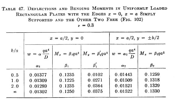

You say you looked in Timoshenko, but which one???
It's right there in Theory of Plates and Shells... Section 48 starting on Page 214, and Table 47.
The table lists various b/a ratios.

But in this case, the average side length is 1025 mm and the thickness to length ratio is then ~ 0.002. Do not treat this as a beam. You should be using Kirchoff-Love plate theory.
The information in Timoshenko should be fine.
