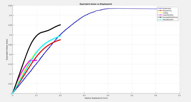

Hello everyone,
I am running a nonlinear analysis with imperfections included by an eigenvalue buckling analysis with a factor of 0.1-0.5 ( the max dmx from buckling analysis is 1 , units are N/mm ) but the stiffness is much higher than the experimental results. How can I reduce the stiffness in order to match the experimental?
Any tips would be really helpful.

I converted the force into relative stress for both the experimental data and the unit cell in order for them to be comparable. I used the unit cell because the whole model takes a lot of computational time.

The two plots in the first post, are they based on "raw" data from FEM and the same the experiment, or is there calculations involved for "converting" them? If there are calculations involved, they could be a source for error.
I would start with a FEM-model close to the experiments geometry etcetera if possible. Or is this comment not valid at all?
Some calculations are involved to convert the force into equivalent shear stress, deciding the force with the area of the specimen and the unit cell respectively.
A model close to the experiments is possible and it's been made but I was trying to reduce the time by modeling a unit cell or a small portion and comparing them.
"Some calculations are involved to convert the force into equivalent shear stress" ... ah, I think it's worth playing with your effective stress to see if it improves the fit.
one interpretation of the original graph is your effective stress is "wrong".

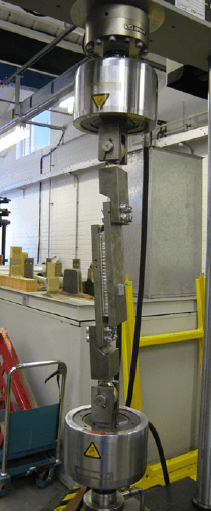

Please post a photo of the complete test setup, showing exactly where the test measured displacements are obtained.

Here is the test setup. The displacement is measured by the movement of the bottom crosshead.
To scale the shear stress I took the force data measured from the experiment and divided it by ( L*W) length and width of the specimen. The FEM results give the force calculated at each sub-step of the solution, I divided the data of the force with the dimension of a unit cell ( the model was that of the unit cell) to get the shear stress. In the bottom photo, you can see how the results are affected by the introduction of imperfections.
The results might seem a bit troubling but the point is that with a large imperfection factor the results seem to make a better fit.
Now look at that test setup. There is flexibility (displacement) in those pins, joints, etc that is not specimen displacement. Proper displacement measurement would use an LVDT between the two specimen loading plates.
Now, look at your “unit cell” FEM. Count up the number of ribbon (double thickness) walls, and count the number of angled (single thickness) walls. Now make a figure of the actual specimen, and do the same counts. Calc ratios of area divided by number of walls, and compare FEM to specimen. I doubt the are the same. And if there are partial length walls in the FEM or specimen then the comparison gets more complicated.
And answer the question about how you adjusted the FEM displacement results.

I have trouble with the test set up. You're applying in-plane load to one face, and reacting it on the other. This is, IMHO, very "odd". This is (again, IMHO) not what the core should be doing. It could well be that this is what you are doing in your design ... ok, but very "odd".
I'd be worried by the secondary effects in the test set up, with the panel inclined as it is to the load. I'd anticipate that the real design will not deflect as this test would.
I would have thought that the core would delam from the face sheets before it failed (in modes I expect for the test set up).
Guys, that test setup is an ASTM standard test method (C273), and it is extensively used for core shear tests. With proper bonding, and assuming the core density is not very high (in which case a beam shear test (ASTM C393) should be run), the test will produce core shear failures, which with hex core is driven by shear buckling of the cell walls.

1. Geometric imperfections. They did affect stiffness, but not anywhere near the magnitude required to get a match.
Note: the OP didn't post any pictures of the real-world specimen here so I won't either, but saying that the structure has "geometric imperfections" is understating how irregular and distorted this hexcore was at the end of its manufacturing process.
2. Full model. At first the analysis was done using a "unit" cell, but that raised the suspicions mentioned in this thread, so we modeled the whole core and got rid of analytical "equivalent area" calculations. Still no match.
3. Geometric refinement. We implemented things like curved hexagonal cell corners (no change in results) and experimented with single/double wall thickness (there was some miscommunication here). No cigar.
All throughout our investigation I kept bringing up to the OP the possibility that the experimental data was "wrong" (meaning it didn't correspond to what we thought it corresponded to), but this wasn't something I could investigate since I'm a remote collaborator. But now, reading back on the replies to this thread, I believe SWComposites nailed it on his first response, which he reiterated several times: the measured displacements are inaccurate. I think this is very likely the reason for the gross mismatch in linear-elastic stiffness, since we've ruled out many other possibilities (except, perhaps, extreme initial geometric distortion).
