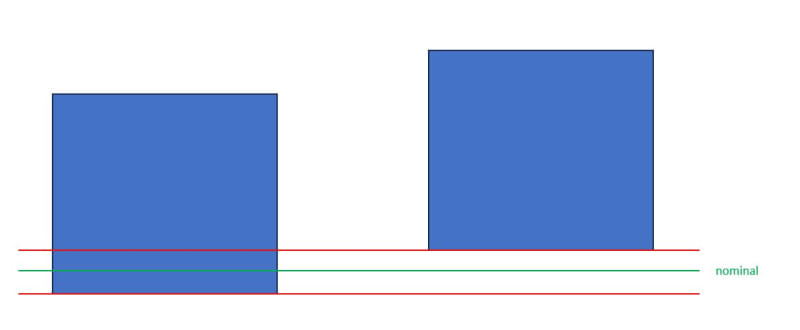

Hi everyone,
I would like to ask a question about creating a datum reference system. Me an my colleague were discussing whether the below is an appropriate GD&T notation. There are two 0-point pockets that are used to construct reference point system. It is part of a larger jig. Picture shown below. My question is, is the GD&T notation below correct? The idea is to create 3 planes from two pockets spaced 250mm or further apart. First a datum feature A is constructed by 2 planes. Then datum feature B which is perpendicular and defined as the combined zone of the two planes. And then the third plane which will be the mean plane between the two planes, so theoretically at 125mm. Is this the correct way to show this?
Thank you in advance for your answers.
Kind regards,
Kevin

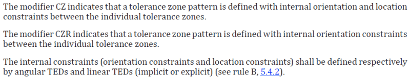

Greenimi,
"Where CZ is indicated in tolerance indicator all the related individual tolerance zones shall be constrained in location and in orientation amongst themselves"
Garland,
This is an excerpt from ISO 5458 5.4.3 Rule C: indication of a single indication pattern specification:
I believe perpendicularity with a CZ modifier could be used to create an internal position constraint on a pattern on holes. I believe the reason you don't see it used that way is because it's not explicitly defined and is confusing.
Ryan.

Greenimi,
Thank you for the clarification.
I appreciate it.
Now you realize that my statement you quoted is a direct copy and paste from ISO1101-2017, right?
So I am not sure why my replay is incorrect, as you indicated, since I was only copy-paste directly from the standard.
Could you, please clarify a little bit?
I asked all this to see if it would be legal per ISO to use perpendicularity with CZ upon a group of features. According to the "letter of the law" in the quote you gave from ISO, it appears that that would be allowed.
But it doesn't sit right with me for perpendicularity to take on the role of location. As Ryan essentially stated, it would at a minimum be confusing.
Sometimes there are overlaps in functions. Example, flatness covers much of the same as profile of a surface. CZ says that the zones are lock-stepped to each other, regardless of the underlying control.
I can see that confusion is not realizing that perpendicularity can also control profile. If it was profile, that would seem more familiar, right?
As for me a geometric pattern is a set of identical features or a device/tool used to create a set of identical features. It weirds me out when it is used as a synonym for "group."
A very interesting thread. I've seen CZ used is several capacities, but I never thought much about the perpendicularity application.
Garland23, does the attached picture sum up your question? (Assume datum feature A is the main face, and TEDs would be given, etc.)

Belanger, yes that's the question I was trying to articulate. Since CZ (in ISO) makes the orientation and location locked among the group, it apparently becomes position in that case. Others can jump in if I'm wrong here.
Still not sure that I like it, but I can live with it :)

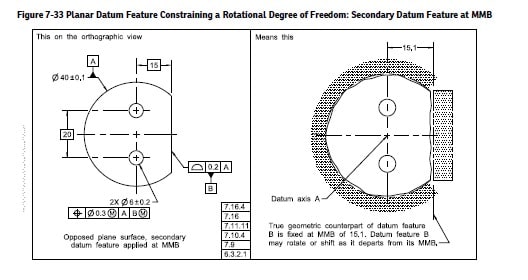

The original OP question has nothing to do with ASME.
I brought it up (ASME) for my own edification of how to "translate" some concepts (7-33) from .5 to ISO.
