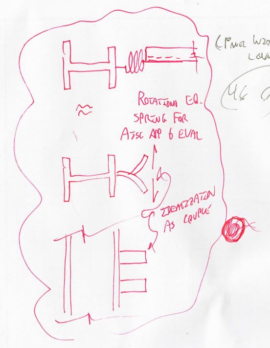

Hi Everybody,
I have a channel simply supported between the columns as shown in the figure attached. The channel is connected to the column flange by a shear tab or fin plate.
(i)As per AISC 360-05 clause F1 "The provisions in tis chapter are based on the assumption that the points of support for beams and girders are restrained against rotation about their longitudinal axis" It means the fin plate or the shear tab should be restrained against rotation or should have torsional capacity ?
(ii) It the fin plate doesn't have any torsional capacity this AISC 360 is no more applicable to the channel since it doesn't quality the assumption of AISC?
(iii) How much is the torsional rotation the fin plate is subjected to?
Please clarify me I am totally confused, because if this doesn't work then the whole world cannot use fin plate connection at all.

Nope, not quite that either. My stance is that the unbraced length of the channel should be taken as the bolt line to bolt line distance but, in addition, the ability of the shear tab to perform the bracing function MUST be evaluated. The evaluation could be numerical per AISC appendix 6 provisions or, as I would normally handle it, by inspection. For me, there is no practical path forward with this that does not involve the evaluation of the shear tab for it's capacity to perform the bracing function.

So it will be nice if somebody gives an example how to evaluate the shear tab as a bracing.
The sun has probably set on this but, since I had the sketch lying around on my desk, I figured that I might as well post it for any interested parties. It shows a concept for treating the knife plate as an equivalent rotational spring. You're on your own for the detailed mathematics I'm afraid.
