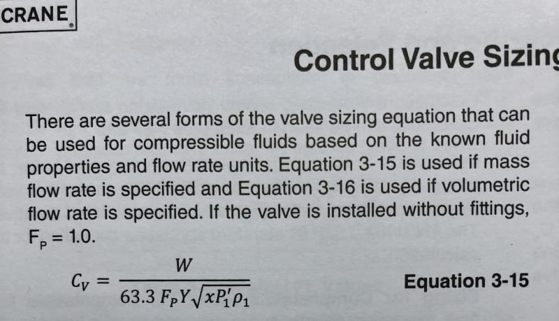

I have to provide 95 psig nitrogen gas to a LN2 dewar switching manifold as the pneumatic actuation gas for the valves that are part of the manifold. The vendor that is supplying this manifold has recommended a high pressure gaseous nitrogen cylinder (size 300) as the nitrogen source since the building doesn't have a nitrogen utility. The cylinder is at 2640 psig when full and a two stage regulator is used to reduce the pressure to 95 psig. I have to follow a standard which requires a relief valve downstream of regulators in the case of the regulator failing open. My question is if the ISA standard equation for determining failure flow rates applies in this situation or does the magnitude of pressure in the cylinder make that equation inaccurate?
ISA equation I am referencing:
It looks fine to me. The expansion factor, Y, is there and it has the critical pressure ratio built into it.
Crane has essentially the same formula in their compressible flow through control valve section:

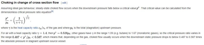

Any calculation will be made based on critical flow so volume is fixed, but mass is increased due to inlet pressure.

N2 critical pressure is 492 psia. Others can confirm, but I believe the referenced equations are good for compressible flow only if the flow is not supercritical. You didn't state your relieving pressure, but I imagine it is below the Pc.

I think my choice of words confused you. It's the critical pressure ratio that is important in compressible flow.

No, I understood that you meant the critical pressure ratio, past which flow is choked and flow is only increased by increasing upstream vapor density.
However, the N2 is supercritical coming through the two regulators. My first statement was just reminding him of the Pc so that, in the very small chance his relieving pressure for the PSV was above critical point, he may not be able to use the given equation because that applies to compressible gases, not supercritical fluids.
