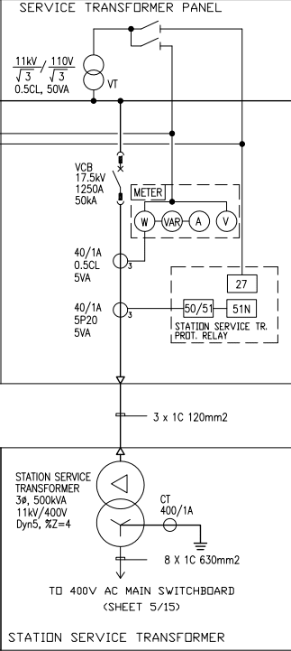

Is 87T able to change the setting value automatically according to generator status so 87T won't activate for tripping while the generator is in stand-still status?

Is there any way to calculate the current drawn by the station service from the grid based on this?
I’d just calculate it based on the transformer nameplate. I get 26A.
If you don’t want trips to the differential due to secondary faults you might calculate the primary fault current for a secondary fault. I get 650A primary. Depending on how big your machine is that might be low enough to ignore (by setting the 87 pickup above that value).

After doing my calculation, I got 26 A for the nominal current of Station Service Tr and the CT secondary current is 0.0874773
For the Main Tr, I got 0.69 and 0.94 (CT secondary current). Can I safely say that if the CT secondary current for SST is lower than the Main Tr, it means that it won't be any problem (red: fault-tripping) to install the 87T between CT2 and CT6? Or does it need more calculation? (can you give me a hint what to do)

We use 0.3 Ie for now. But, how to make sure that it won't trip if the generator stand-still and SST takes power from the grid? I still don't get it, sorry.
I already calculated the nominal current, rated current, and CT secondary current for MTR and SST. Can you tell me what I must calculate after that? Thanks
The “operate” current is the same whether the gen is running or not. The current from the gen is canceled out due to the proper polarity of the two sets of CTs. The only load current that will cause “operate” current is the loads from the smaller transformers without CTs as the transformer primary CTs will see the current if the gen is not running, and the gen CTs will see it if the gen is online. Makes no difference.
The only difference between the two scenarios is when there’s significant load the restraint current will help reduce the affects of steady state errors.
So... is it impossible to do what I proposed in the beginning?
I’m saying you don’t need to. Differential will work fine as is.

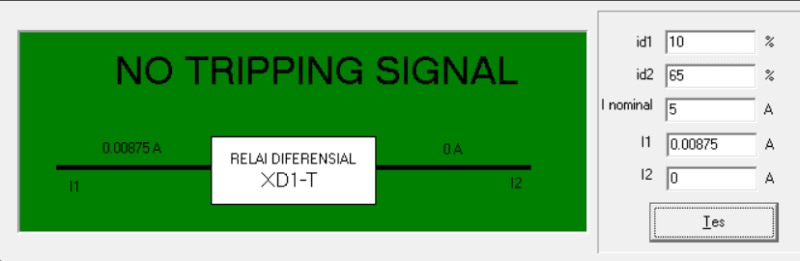

Here's what I calculate and my assumption (please CMIIW)
Currently, the setting pickup value (I_Pickup_Percentage Differential) is 0.1 Ie (Ie = 5 A)
The ratio turns of CT are 300:1 (HV side) and 3000:1 (LV side)
The primary side of MTR (150kV) CT2:
I_1 primary CT = 206.7 A
I_1 secondary CT = 0.6546 A
The secondary side of MTR (11kV) CT6:
I_2 primary CT = 2818.52 A
I_2 secondary CT = 0.8925 A
The slope setting is 10% and 65%
SST (on secondary side of CT):
I_3 primary CT = 26.24 A
I_3 secondary CT = 0.00875 A
Since the I_3 secondary CT is lower than 0.5 (0.1 Ie which is the setting pickup value), my conclusion is: It is safe to install the 87T between CT2 and CT6 when generator stand-still
Please tell me what's wrong with my calculation and obviously my conclusion.
Thanks.
(Here's the simulation that I tried)
