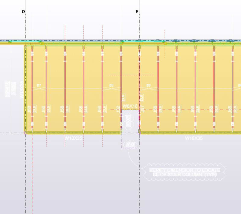

drawoh, this has little to do with intellectual property. You work in a different world, and your files are usually something you build from. I have downloaded endless mech models from McMaster Carr and grabcad for projects and they are fantastic. We work with many silly people with unrealistic timelines. We recently had a set of EOR dwgs that contained a +- symbol for the joist spacing.
Releasing CAD files anymore is not that important. If you share rasterized .pdf files it takes nothing to convert to .dxf. Below is joist layout imported into our tekla model from their pdf files.
My *.pdf to cad translator often takes care of redacting, too... I guess it depends on how it was created.
