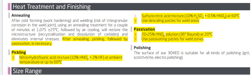

It was then suggested to me at a metallurgy forum that I was dealing with smut left over from the steel manufacturing. This 1976 paper appears to describe what I am dealing with:
The paper above indicates that the only efficient methods to remove smut from 304 are concentrated HNO3, or chromic acid, or HF. The paper also mentioned electropolishing+HNO3. None of these are DIY-friendly methods, and I do not have access to a chemistry lab at the moment.
Should I give up on the piece and re-oder it in another material that is not as hard to clean and make corrosion-resistant? Or, I could try and outsource the desmutting/passivation. If I do, is there a standard protocol (USA or, preferentially, EU) that I should specifically request from the facility? There are shops within 1 hr who offer SS passivation, but HNO3 or electropolishing are not mentioned. I beleive they mostly do NaOH followed by citric acid -- and this has not helped, as I already tried.
Or, should I have the piece coated all over with PTFE or enamel? These options sound expensive, at least with a one-off piece like mine.
If I have to re-order this from scratch, what spec should I request -- HNO3 electropolishing, followed by an IPA smudge test of the finial product? Or use a differnet material, like a Ti Gr5?
