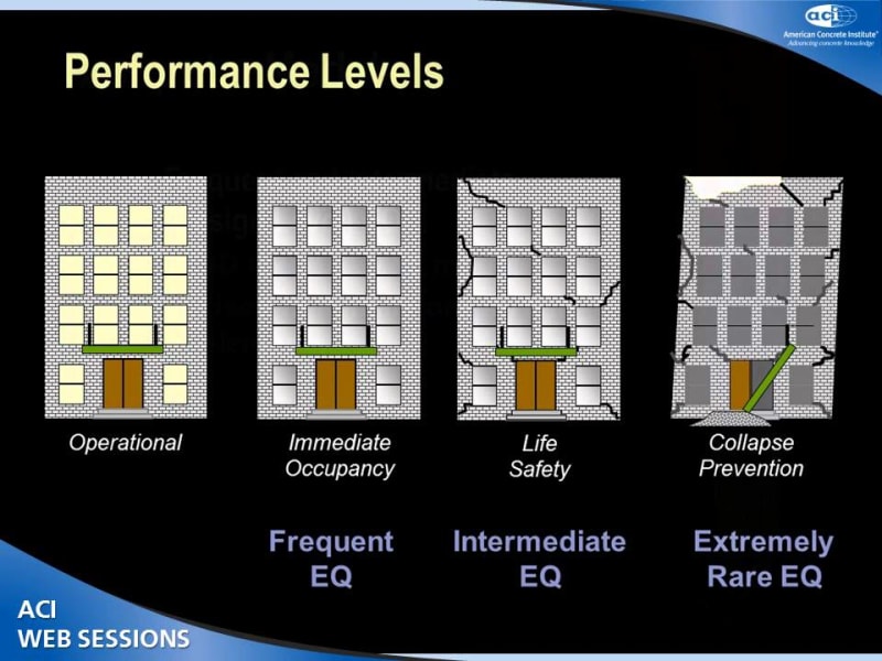

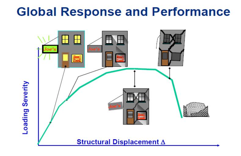

You may compare the general situation and global response of the bldg . with the following pictures;
If the question pertains to rebar found in the yielding zone of the say; 10% beams , the beams and cracks could be repaired with repair mortars , plaster etc..
The limited yielding of the beam rebar is not the end of the game.. still residual strength could be available..

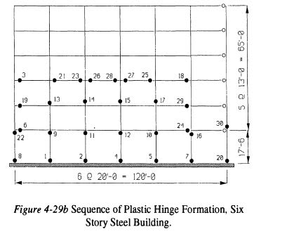

Remember sway mechanism .. if some of the beams develop plastic hinge , the structure still has potential strength ..Try to evaluate performance level after a seismic event..
The following pic. from SEISMIC DESIGN HANDBOOK , explains the sequence of plastic formation;
