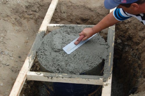

May be I will try the 12" sonotube approach, set it into the large hole, insert the post, then need some 2X4s to brace the post so it stays level. Then backfill the soil around the sonotube and compact as much as possible without deforming the sonotube. Then pour concrete into the sonotube. Once the concrete hardens, compact the soil around the sonotube a second time, as much as possible.
This is the best approach, with one caveat. Your order of operations here is set sonotube - brace sonotube - place concrete inside sonotube - let concrete cure - backfill around sonotube.
You cannot compact soil around a sonotube to the level required for real lateral support without collapsing the sonotube. Do it after you place the concrete and you can ram it in as hard as you want without issue.
Bracing the sonotube is relatively easy; this is how it's done in the commercial world:
In other words, you don't have to go crazy. Couple 2x4s, couple wood screws, couple concrete pins and you're done.
