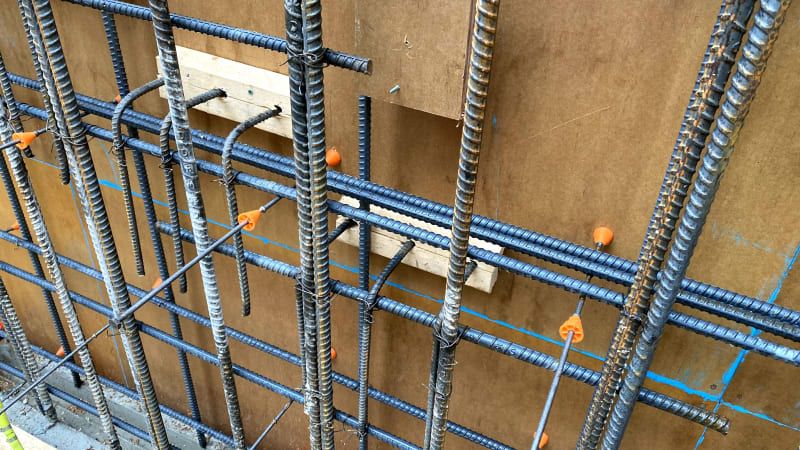

Hooked bars sticking out of the formwork with 2x knockouts for a shear key. Here's a close-up of one of the photos above.

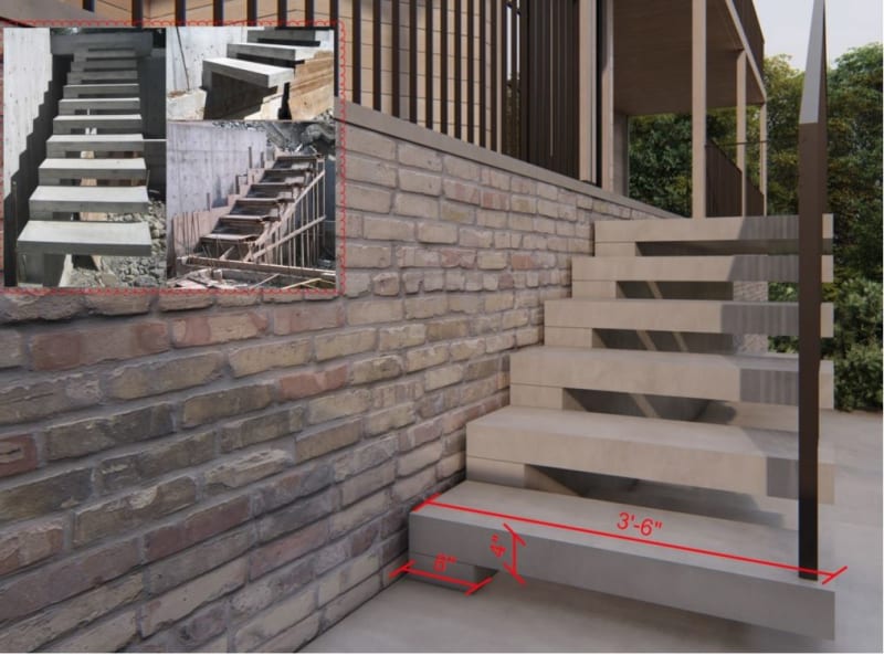

Tell the architect that the stairs they are showing you an example of are thicker than 4". very much thicker. What is the obsession with the 4" thickness?
Are these exterior stairs? If so doesn't your local concrete code dictate clear covers to reinforcing? I doubt that you'd be able to get clear cover above and below and the thickness of the steel. The steel would need to be at essentially mid depth. Then when working the stair so hard, it's likely that the neutral axis depth would be almost half of the section depth. That would render the steel essentially useless. You'd have almost no strain at the steel meaning no yield.
The architect is pushing the limits. The stair in the photo has a cantilever of 3'-6" less 8", or 2'-10". For a solid slab, the code calls for a thickness of L/10 which, for 42" would be 4.2", so this stair is likely to be a little springy. Maybe the handrail could be designed to spread the live load over several steps.

Either my eyes are way off or the dimensions on the photo are a dream and not the actual for that stairs.
They sure look 6" thick to me.
Look back at the photos from TidePool

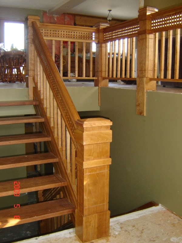

This is the kind of hand rail that it takes to get real load sharing.
I could see going 5" with that style of hand rail, but not with posts.
They are not 6" thick. Look at the gap. If they were 6", the height of the riser would be about 10". My guess is they are 4" thick, 3" gap, for a 7" riser. Maybe 4.5", 3" gap, 7.5" riser.

1. If cast in two pours I suspect they would want the construction joint at the bottom of the treads. How one bends the primary rebar into the tread will be important, and unless you have a good trade this could be a problem for you to deal with on site.
2. As Jayrod mentions, where the rebar ends up is important and if poorly done this would not work.
