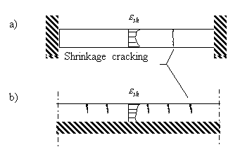

I deal with shrinkage cracking in composite materials. One important point to be aware of is that volumetric shrinkage can be almost entirely in the unrestrained Z-direction, when the X- and Y-directions are restrained by reinforcement.
This picture depict the type of shrinkage well. It is helpful when plan the steel reinforcement.

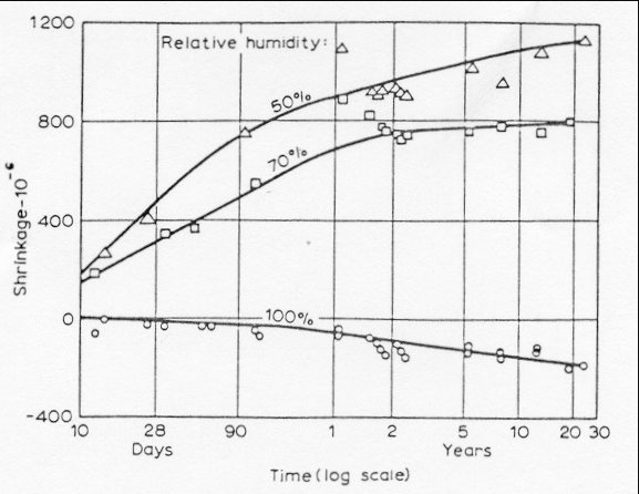

Another interesting chart - shrinkage vs time and relative humidity.
