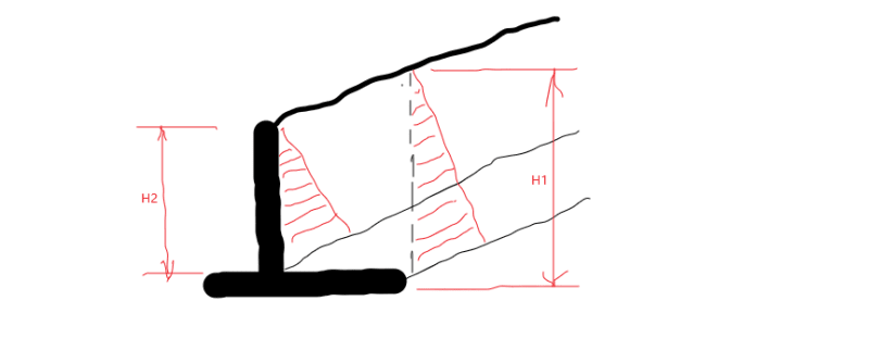

Hi everyone, I am having a debate with another engineer and i want your thoughts.
I am using Coulombs Theory to calculate the Total Active Pressure, Pa acting on the retaining wall shown in the picture.
1st step:
calculate the coulombs active pressure coefficient, Ka which is 0.556
2nd step:
calculate the Total Active Pressure, Pa:
Pa = 0.5KaγH2
Ka is the coulombs active pressure coefficient = 0.556
γ is the unit weight of retained soil = 20kN/m3
H is the height of the retained soil
My question is, what shall i use for height of the retained soil, H in the equation above? H1 or H2 (see picture)
What friction angle for soil and wall in your cal?
Were you use soil friction angle 35°, slop 33° from horizontal? I'll try it later.
As in the diagram in the OP - 35 degrees. As the "wall" failure plane is through the soil I took 35 degrees for that friction angle as well.

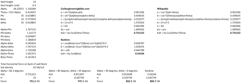

I think my numbers are right, I checked them using two different versions of the Coulomb equation, and the results agree with published tables. Are you taking the back of wall angle as the slope from the back of the heel to the back of the top of the wall?
I did make one correction though. In my earlier number I took the heel length as 3.8 m, but it should be 3.8+0.6m, which gives a Ka of 0.73.
I have attached a copy of my spreadsheet, and a screen shot below.
I have added total horizontal force calculations for:
1) Wall angle, alpha, as described above = 66.25 degrees.
2) Vertical wall, alpha = 90 degrees, with H = height to top surface at the back of the heel; "wall" friction = 35 degrees.
3) As 2) but wall friction = 0
4) As 3) but using Rankine Ka
Note that 1) and 2) give very different Ka values, but the forces are quite close, with 2) being slightly more conservative.
Also note that these calculations are for the total force on the wall. For calculating the force on the wall stem the failure plane would start at the bottom of the stem, so the alpha angle would be the angle of the face of the concrete.
By the way, I very rarely do cantilever retaining wall design (I usually work with MSE walls), but when I do I have used the Rankine equation in the past.

kellez said:
Please have a look at the two pictures below, its the same wall however in the second one, i highlighted the retained soil above the heel just to show what would happen if the highlighted section was also concrete? (it is said that the retained soil above the heel inside the virtual plane is assumed to be part of the wall)
What you have drawn indicating Rankine state (note that this failure mechanism is incomplete per Coulomb's perspective), in which, the wall and the soil on top of the heel is treated as a monolith, to resist the earth pressure caused by the failure soil wedge to its right. Yes, you should use the height between the heel and the sloping ground for earth pressure calculation to check stability of the monolith, however, you should only use the stem height in calculating earth pressure for the design of the stem. The important thing is, if you elect to use this method, you shall calculate Ka per Rankine's equation, not Coulomb's as in your opening statement. The graph below speaks my point.
Thank you everyone for your responses. So in summary, the virtual plane is only assumed if you are using Rankine theorem, where's Coulombs assues a wedge behind the wall.
IMO, yes.
I'm having trouble understanding some of the replies here, and I realize people note that textbooks and manuals don't often show Coulomb theory with cantilever walls but I still want to make sure everyone understands this: Rankine OR Coulomb can be used in cantilever wall applications.
I think Coulomb is shown on oddly shaped gravity walls in textbooks and manuals so often because they want to demonstrate how to use it on irregular wall shapes.
Coulomb is more accurate with active pressures but is not recommended for passive pressure since it could over-calculate the passive resistance.
I hope that clears things up a bit.
