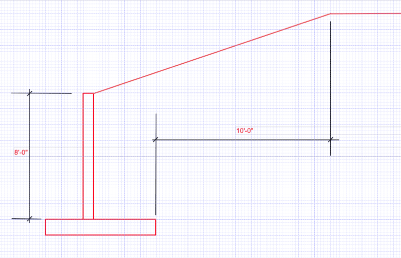

At what distance from the face of the wall is it ok to assume the backslope "infinite" and disregard where the backslope is broken (and any surcharge associated with broken slope)?
For perspective, lets say you have a 8-foot tall retaining wall with a backslope at 3H:1V which is broken 10-feet from the heel of the footing. Where the slope is broken, there is a parking lot. Is it ok to assume a infinite backslope condition and assume the vehicle surcharge is far enough away (distance of surcharge > height of wall) from the wall that its affect on the lateral pressures is insignificant? Or should you calculate the earth pressures with the backslope and conservatively add the vehicle surcharge lateral pressure as well.
