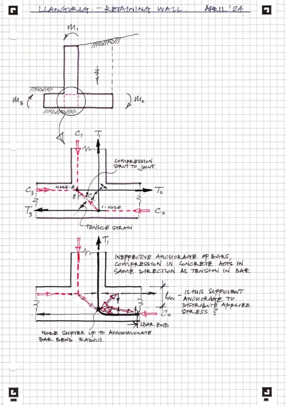

The rc concrete base and starter reinforcement bars have already been cast as per the engineers sketch attached. The first glaring error is the L-bars are backwards. I did raise this concern with the Client however he doesn't want to spend the money ripping up what has already been done.

Given the current starter bar config, a strut-tie model would use a C-T-T node at the L-bar turn into the base reinforcement, putting the Lbar longer leg into tension and the shorter leg in compression. Would anyone like to hazard how thid analysis would even work?
I am concerned with brittle fracture of the concrete (even with the reduce stem height) due to the opening up of the junction between stem and base.
Sounds like a proper mess, but you may not have to rip up what has been built. Starter bars are H10-100 (850x400). I assume that means 10M bars @ 100 o/c. If by "backwards", you mean the horizontal leg is pointing to the toe instead of the heel, I would not think that is something to worry about, but others may disagree.
I have no idea what B1131 or B 785 Mesh Fibre means, and whether or not it is adequate for a 2m high retaining wall. I suggest you check the reinforcement which has been placed. If the starter bars are deemed to be too short, weld extensions. If they are not adequate, perhaps you can add new bars drilled and epoxied into the 360mm thick base.
I don't agree with the red text, but I could be wrong. Maybe someone else will comment on that.

All I meant by the highlighted part in red was a FBD of the stem and heel gives corner opening moments thereby inducing tensile stress to earth face of stem and top face if heel, meaning the LBar short leg winds up in a compressive zone. So my concern from a bar stress analysis point if view was how to deal with the transition from tensile stress to compressive stress with a radial bearing stress and bar slip...

Just to clarify the offence in question. Was down at site today and client informed me of reply from original engineers. So I fired off a sketch in response, as original engineers trying to justify bar orientation
I'm perhaps missing something, but each of the elements (I assume at this height) are designed as singly-reinforced cantilever sections. Detailing aside, the presence of the compression reinforcement in each of those elements is immaterial. Notably, if you've since altered this to a cavity reinforced wall, typical detailing provides only for a single layer of tension reinforcement. As such the tension lap orientation and length shown for the stem on the original calculation seems acceptable to me.
If compressive stresses in the reinforcement are a concern (I suspect not at the reduced height?) then each section could be analysed as doubly-reinforced to obtain.
