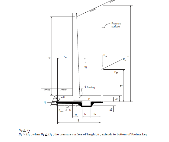

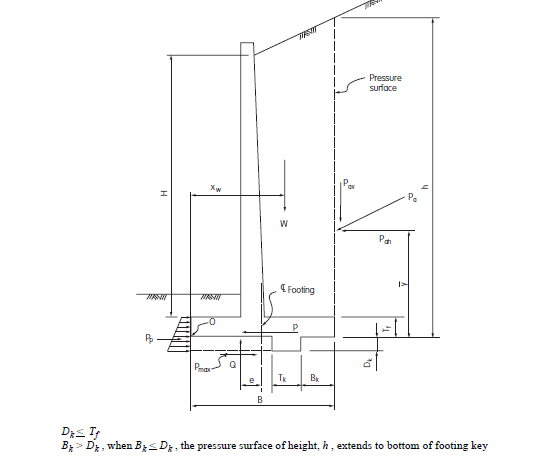

One picture worth one thousand words.. ( Ref Caltrans bridge design specifications SECTION 5 - RETAINING WALLS )

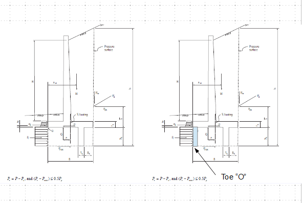

In this case two pictures worth two thousand words.
My thinking of rotation point, "O", differs from HTURKAK.
The Caltrans guidance has a sudden step between no active earth load on the shear key (shallow case) and lots of active earth load on the key (deep case). That's a pointer that it may not quite reflect reality. For comparison, British Standard BS 8002 simply says to take the active pressure to the base of the key, so does not have the Caltrans relaxation for shallow keys.
In the Caltrans shallow key model, is the assumption that the soil behind the key self-supporting after the wall moves slightly away from it?
Shallow key model requirements ;
Dk < Tf Bk > Dk , when Bk < Dk , the pressure surface of height, h , extends to bottom of footing key..
IMO, your assumption is correct.. the shallow key model is chosen for to mobilize the base friction at a lower level . The soil bearing stress approaches to zero level around heel and the active pressure will be negligible since for mobilization of soil friction, passive resistance due to shear key will be necessary that is, wall moves slightly ..

Yes... look to the first picture.. the requirements are shear key depth ≤ depth of footing ( Dk ≤ Df) and the other requirement, Bk> Dk ..
The use of shear key is required when one can not get F.S. against sliding which is a common problem when the base of footing has waterproofing membrane or tanking of concrete with epoxy paint etc. Consider the the steps of construction, for a shallow key conforming the requirements, you should provide a recess at binding concrete . The friction surface will develop below the bottom of blinding under the key and for developing of shear surface, some passıve pressure should develop , that is the wall should move slightly.. behind the shear key , the active pressure developing will be negligible or zero, since the bearing pressure under the footing around heel will be minimum.

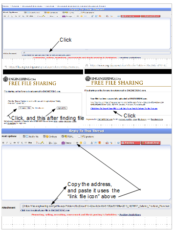

CALTRANS BRIDGE DESIGN SPECIFICATIONS including SECTION 5 - RETAINING WALLS is an open source . I tried to upload subject document but could not succeed .( If somebody tells me how to upload , I will appreciate )

Here is the link..
Thank you so much R 13..
Link

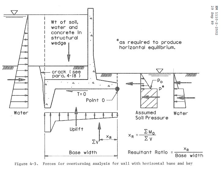

I didn't see anyone mention USACE retaining wall design methodology. EM-1110-2-2502. Which, by the way, has the same problem. However, I think this is a better standard than what most text books show.
BTW, if you're unfamiliar with flood walls [EM documents are free and easily downloadable], the shear keys are typically placed at the back of the heel vs what CRSI and some text books shows.
Tall flood walls are a bit more serious than drained walls that are 8' tall or less, which are relatively forgiving.

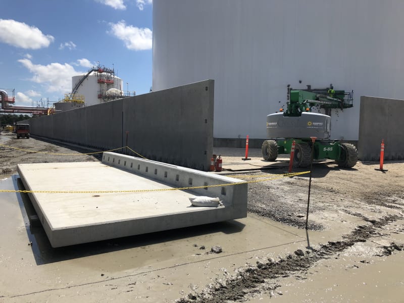

I have options for a precast wall using a cantilever design and cast in place foundation.
