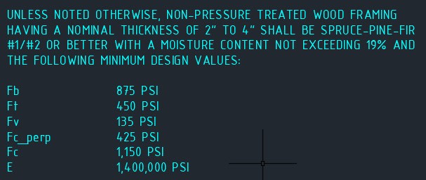

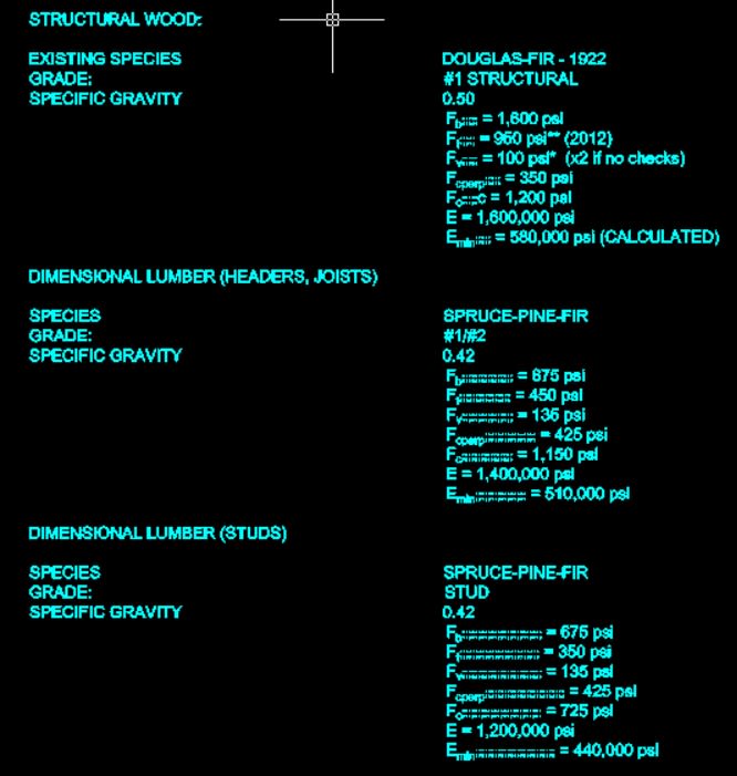

I usually specify minimum allowable stress values on the drawings. Since I do a fair mix of new/old fix/retrofit, I usually disclose the design values used for the old wood as well.
Please excuse all the excessive semicolons. It's something by cad program has decided to start adding every time I touch the drawing.

Agree with lexpatrie. My notes are similar:
I have similar notes for LVL and PSL material. For LVLs in particular, I always design for the lowest values that a builder might realistically find locally. For example, I think a Parallam LVL has an Fb of 3100 psi. This is great and all, but I find that when engineers design based on this value, they'll often find a Microllam LVL installed on-site with an Fb of 2650 psi. In general, I think it's wise to very explicitly state what the material properties are expected to be.

For me, I don't really care to cater to the latter. Just because some builders won't read my notes or look at my details doesn't mean I shouldn't have those notes or details. I like to think that the engineering actually matters and that at the end of the project, between my (hopefully) well thought-out plans and a competent, detail-oriented builder executing them, the end result will far exceed what might have been without an engineer and without a decent builder. Maybe I'm full of crap, I don't know. I certainly don't think it's foolish to explicitly state the materials that I expect to be used on the job. If there were an issue later, I generally like to have things clearly documented.
And at the same time, to XR250's point, I still try to provide designs where I'm not pushing the limits of what a particular material is capable of. That way, I have a bit of a buffer if there is a mistake.

It seems like the summary of the article is to spec the Fb, Fv, Ft, Fc\\, Fcperp, E, and G of the material you're using, instead of just the species and grade so that it is easier for lumber yards to substitute stuff that is equivalent or better.
Am I getting that right?
