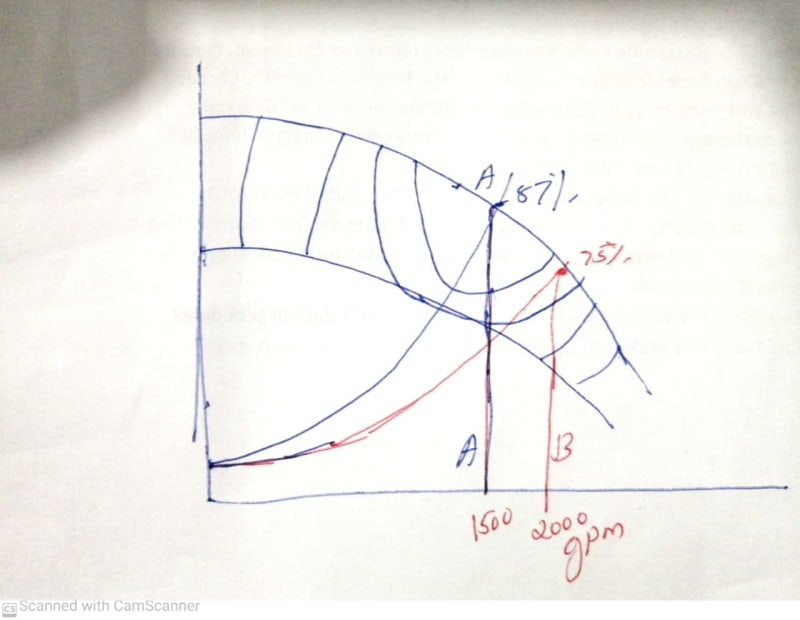

@1503-44: My technical view that the VFD is not fit or consistent when the pump curve and system curve intersect away from BEP, because when reducing the system curve during the time of speed reduction, the efficiency curve will still be kept in same low efficiency area. Am I correct?
So, the selected pump’s control panel has two option, one vfd and next star delta. During peak load pump may work with star delta to prevent the drive loss and will work with VFD at part load condition.

@1503-44;Thank you for the comment, I agree with you the point explained, but I afraid you misread my argument. I pointed the condition that ‘away BEP’, I mean that the oversized pump’s system curve moved to right side of pump curve, the area of low efficiency and cavitation. When goes to my first post, when the oversized pump work with ‘AWAY BEP’ condition and a new VFD fitting to this pump as part of reducing the head and flow, in this situation the system curve kept in low efficiency circle though the flow is reduced. for example, look at the hand sketch of curve A, at BEP, the pump is working at/around 87% efficiency always when VFD is reducing the flow rate. Curve B, the oversized pump is also reducing the flow with VFD at 75% efficiency

Of course when your system curve does not intersect the pump's BEP region, results of installing a VFD will not be ideal. In your example you would indeed have an efficiency of 75% at every rpm. I wouldn't say a VFD is not necessarily a good solution however. If you wanted to operate that pump on the red system curve B, but at a flow rate of 1500gpm and a head close to 60% of the pump's rated speed head, then installing a VFD would let you do that at 75% efficiency -3% eff for the VFD loss = 72% eff. That's not 87%, but still not all that bad. VFD is one option. Let's see what else we could do.
Looking at other options, you could also operate at that same 1500gpm, 60% head point by using a constant speed pump fitted with a control valve and it looks like you can probably get close to 75% efficiency, so that would have the same or even a slightly greater benefit than using a VFD would have. Great, now we have two viable options. We should probably now look at the capital costs of each one, see if we have electric power available there, room within the pipe configuration for a control valve and also evaluate maintenance and operation implications. Let the results of the study determine your selection.
In your example we see that there is no clear cut advantage, both VFD and CV could be viable options. Looking at the point of intersection of the constant speed pump curve and the red system curve B of that example, it shows a flow rate that is roughly 20 to 25% away from the constant speed BEP flow rate. Now remember what I said in my first answer to your post. Systems that operate within +/- 10% of BEP flow rates should generally not need VFD. Roughly stated, long periods of operation, maybe 30-50% of all operating time, at flow rates >25% away from BEP could favour a VFD..
Your example falls right on that border line. Q of around +20% -25% rated BEP. So I would probably recommend a CV in that case, if I had room in the pipe configuration to install it.

@1503-44-"Of course when your system curve does not intersect the pump's BEP region, results of installing a VFD will not be ideal"- now we are on the same pitch. this was the content of ours chat. thank you very much
That's the only pitch. Its difficult to fix the wrong pump selection. You can only chose the best option to live with it. That could be a VFD or a CV. Do the study and pick your poison. However just saying a VFD is unfit for that situation in all circumstances isn't exactly correct. It may be your best option, maybe not.
