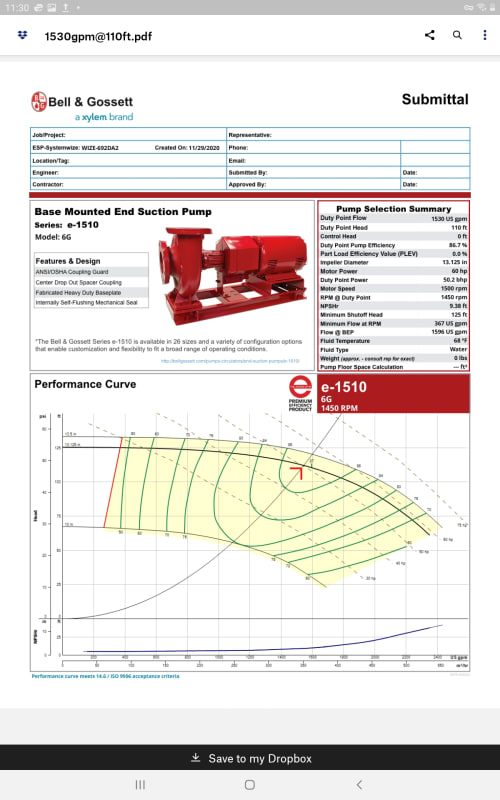

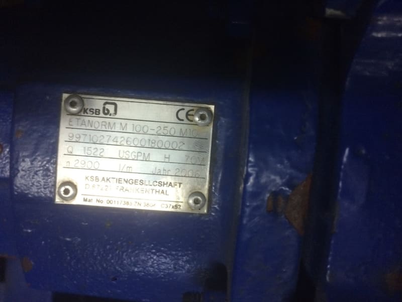

@Artisi: Flow is 1530 gpm, not the 1350. I had checked the old pump curve in the submittal file, it was missing and checked with supplier with pump serial number. But, they couldn’t to find. I attach here with old pump name plate. I checked the flow rate of old pump from balancing valve, that was 1720 gpm, difference from design 190 gpm. Ampere name plate 90 KW , but draws 186 amps it means around 110 KW above the name plate. So, it can confirm the pump is running with right side.

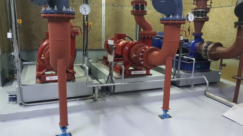

Top marks for a nicely laid out clean pump room.
a curve would be nice - but never mind - reducing pump speed / diameter you could probably get near to the duty you want but not efficiently in terms of power running cost etc - plus outlay for VFD, anyway - your problem has been sorted.
I was after curve for the KSB unit [wink]
