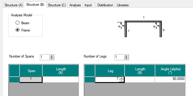

Rod, interestingly enough, BRASS-GIRDER does accomodate these. It's under the Control Option for Structure (B).
Yes, STrctPono BRASS-Girder will do the analysis of the frame, and it's fairly straightforward. The more difficult aspect of the design is in applying the loads and resistances of the soil. The conservative approach would be to apply no passive resistance to counteract the loads on the span, but then apply full soil pressure with the minimum dead load on the span. How conservative that approach is, is difficult to say.
Working in Washington DC, they have a lot of longer span older rigid frame structures that I have load rated. Easy to analyze but there isn't any software that can perform a load rating so it's all done with spreadsheets to calc out the capacity of the variable depth span.
there isn't any software that can perform a load rating...
If you properly account for the soil loading/resistance, or ignore it, BRASS-Girder will provide load ratings.

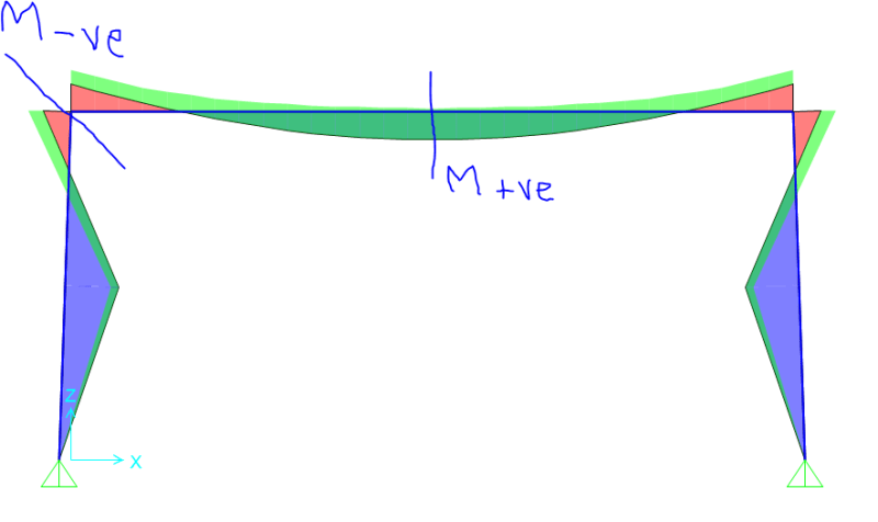

I have a situation where the mid-span capacity exceeds positive moment demand (that's good)
End-span capacity exceeds the negative moment demand (that's good)
But the negative moment demand on top of vertical wall exceeds its capacity there. What do we do in this case ? Any suggestion ?

Do you only check capacity of the deck ? or the vertical wall too ?
You are supposed to check the walls also.
A few thoughts....
1. How are you calculating your effective section strip width? This is one category where I have implemented different strategies that I feel are reasonable and do not blindly follow the provisions of AASHTO for slab bridges.
2. What kind of boundary conditions or earth pressures are you applying in the model that you have shown above?
3. Are you utilizing the effects of the axial force on the walls? This will actually provide you a small additional amount of capacity. Think of the interaction diagram for a column with bending and a small amount of axial load.
4. I'm all for trying to tweak the model and play with the numbers to try and get a load rating to come out (within reason) but how old is this structure? Sometimes a load rating factor less than 1.0 can be warranted. However, if the structure is in great shape and is showing no signs of distress then I would be suspect about giving it a deficient rating. The fee on the job is also going to heavily influence how much tweaking I would be willing to do.
STrctPono
1. I am taking 1 m width in analysis. So my Finite Element (SAP2000) frame model is 1 m wide perpendicular to the page.
2. Triangular earth pressure with Ko = 0.5 (coefficient of earth pressure at rest)
3. I did not check P-M interaction.
4. The rural bridge (over 60 years old) was inspected, and no significant sign of distress on the wall was found.
