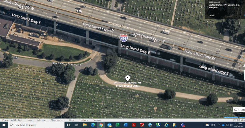

See attached. Here's a picture. The bridge was built in the 1950's. In the 1980's I worked with the gentleman who designed it.

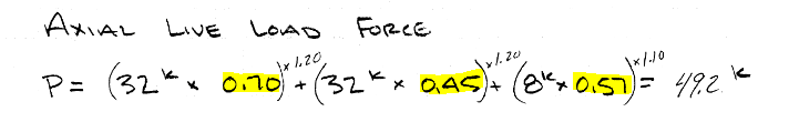

@ bridgebuster
I was reading through your calculations for LIE over Cemetery Rd. I was able to follow it easily until I came to this part. Do you remember how axial load was calculated ? Where did these highlighted numbers come from?

@tmalik3156, I didn’t work on the calculations but I looked at the STAAD output for the influence lines. Joint 15 controls, which is Load Case 9. I found two of the coefficients for Member 6 but I need to another look about the third coefficient; I think I know what they did.
