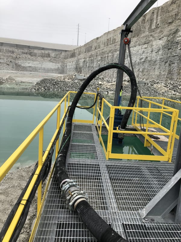

There's no supports underneath the platform. The left side of the platform beyond the yellow centerline in image2 is on the ground and the right side is suspended in air. The 2 pins shown in RISA model I have no clue why they were put in by the previous person who built the model. If I get rid of them and try to solve I get an error. One thing I am going to try is DaveAtkins' suggestion of taking the Y reactions. I will also try to put fix reactions on the nodes as majority of the platform is on ground.
WinelandV : This new job is majority structural and I will be using RISA a lot but I am from Mechanical background so I put Mechanical in my handle. I should change it to Structural if it allows me.
Below is a picture of it currently is. The chain hoists and support structure will be removed also and the new pump will be installed by crane.
Like I said a ton of unknowns here for any of us to truly be helpful.
Is this dunnage just resting on the ground adjacent to the body of water?
The RISA model is completely inaccurate.
“ If I get rid of them and try to solve I get an error.” yes because the model is unstable without supports, boundary conditions are essential to a structure model.
For a grillage on earth you’d need to look into continuous spring supports and probably significantly reduce the stiffness of the springs for several feet adjacent to the body of water accounting for the saturated soil being “mushy”

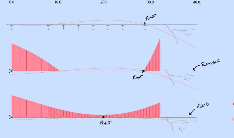

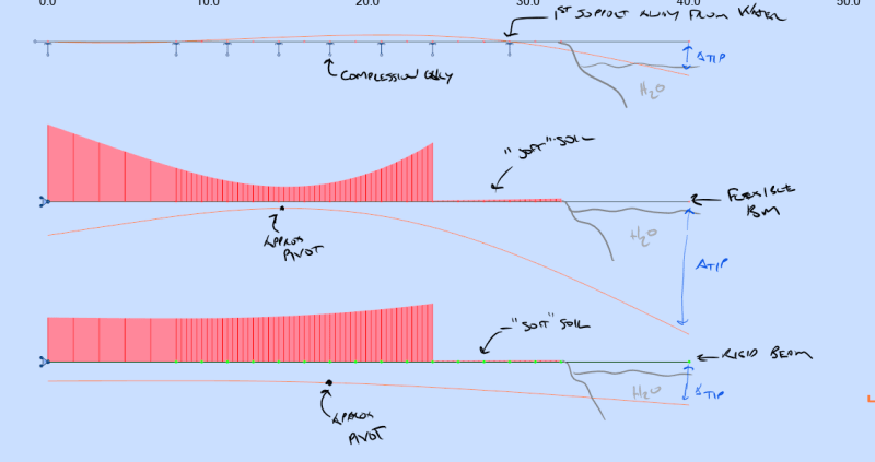

Here is a purely fictitious 2D model to illustrate some points:
Top model - Compression only supports, first support some distance away from the water. First support acts as the pivot counter weight highly effective
Middle model - linear compression only springs with a "soft" spring region adjacent to the water. Dunnage beam is moderately flexible. The apparent pivot point moves much close to counter weight reducing it's effectiveness
Bottom model - same as middle but the beam is now very rigid. Model moves closer to rigid body motion the pivot point moves closer to the body of water but still considerably further back than the top model.
and illustrating the case where the ground is incredibly rigid with all other parameters the same:
If it were me, I would determine the required counterweight using a pivot point at about the middle of the dunnage span away from the start of the cantilever over the water.
If this is at the bottom of a quarry and sitting on a solid rock base then I'd run with the compression only support model with one node defined as horizontal restraint which will come from friction of the dunnage against the ground. I would load this model with the counterweight determined from the step above and the design the system with and without the crane at the free end loaded. I'd probably place the first compression only support 5-6 feet away from the water as a gut feel move.
