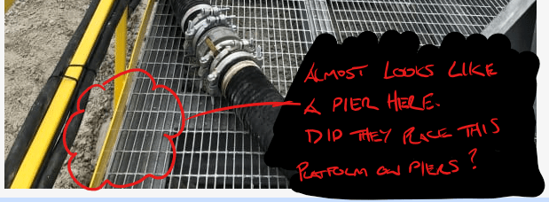

I am new to RISA and taking over a project from a guy who left the company. This project has a platform with grating all around except at one end (See image2). Currently, in the opening on right side of ACAD image, there's a crane suspended pump and to counter it on left side there's 2 5 ton blocks. Now, the pump is being replaced by vertical turbine pump which approx. weighs 2500lbs more than previous one. So I am trying to figure out how much more counter weight I am supposed to put so that the platform isn't tipped over. If you look in image2, the platform is on ground till the yellow phantom line and is suspended in air yellow phantom line onwards. The RISA file the previous guy built I am not sure is quite right or what more modifications are required to make the project feasible. I ran the model with existing conditions. I have the attached them as well. I have below questions:

It's too late now as the thing is in place but I probably would have likely directed them put down a grout bed at the locations that I wanted to guarantee and help spread bearing support to account for the likely unevenness of the ground surface.
Actually almost looks like they may have drilled and grouted some piers in the picture, verify if they did that and the locations as this would change the modeling approach to use discrete compression only supports at each grouted pier.
