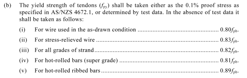

Can anyone help me in regards to the tendon design for rock anchors used in retaining wall?
I am using AS4678 and wondering what tensile strength fp below refer to? Is it breaking strength or yield strength?
I used yield strength but 3x15.2 tendons only gives me less than 500kN. In this case I wonder how other engineers use 3x15.2 (even just 2x15.2) tendons for 6m retaining walls where the tension is greater than 500kN easily?
I also want to clarify the concept of working load and proof load.
Say the design tension is 450kN and I am using 3x15.2 tendons with 470kN capacity (with fp = fpy for the above formula). Now the working load Pw as per AS4678 is 60% of its yield strength which is 386kN and proof load is 1.1*Pw = 425 kN which is lower than the design tension. Is it acceptable that the proof load is lower than ultimate design tension in anchor?

Ultimate strength. There is no well defined yield strength of high-carbon content prestressing steel.
For low-relaxation (and therefore stress-relieved) 7-wire strand fpu = 1860 MPa (check your code or local supplier).
Usually you would stress and lock-off the tendons (Pj) to say 70%, or 75% or 80% of ultimate tensile capacity. This is jacking force/load.
For 3 each 15.2mm ø (@ 140 mm2 area each) = 3 * 140 mm2 * 1860 MPa = 781 kN.

Thank you for your response.
AS 3600 define the yield strength as below.
If I use the breaking strength, doesn't that mean the tendons are allowed to yield? Won't it cause increased displacement issue?
Does the lock-off load and proof load need to be greater than the design tension? ie. S* < min (Phi_k*Phi_t*Phi_n*Ap*fp, (0.7 to 0.8)*Ap*fp)?
Thank you Agent666.
This is where I got confused. Proof load (and working load) is defined by yield load as per AS 4678 while the tension capacity is defined by breaking strength (not sure about this)?
Does that mean the capacity of tendons need to be more than 1.5 times the design tension cause otherwise it might fail when applying the test load (proof load)?

I don't have British Standard. Is tension capacity defined by breaking strength? Cause AS 4678 doesn't say whether it is yield or breaking as shown in the very first pic I attached. (Lock-off load as per AS 4678 is not greater 0.75 of yield strength. Working load, proof load & lock-off load are all in related to yield strength).
Below is the breaking strength from AS 3600.
If I use 3x15.2 tendons. The capacity according to AS 4678 (the first pic with breaking strength) is 0.9*0.9*0.9*250*3 = 550 kN. ie. 0.73*Ap*fp, which is similar to 1.5 times the design action.
Even tendon is not designed to proof load but design action only, does it still sound reasonable for retaining wall with 6m retaining height, 2.4m pier spacing with 3x15.2 anchor installed at 2m below NGL? I have done the quick check with rectangular soil pressure and 20 kPa surcharge and 0.5Ka. The tension will be greater than 600kN. I have reviewed some plans from other firms and 3x15.2 have been used even their comps shows 600+kN tension in anchor. Don't know why. Maybe I missed something or it was just aggressive design?
For strands it say tensile strength in the standard. This is the ultimate tensile strength. Strand strength is almost always a function of the ultimate strength.

I find AS4678 confusing as they do not define what they exactly mean by working load. In your original post, when you say the design tension is 450kN, is that 450kN a working load or an ultimate load?
Ingenuity is correct in that 15.2mm 1830MPa strand has a minimum breaking load of 262kN. The 0.1% proof force (yield load) is 214kN. So your working load would be 0.65 x 214 = 139kN.
The rule of thumb I was given by an anchoring subcontractor is that each strand is good for 150kN working load and a typical lock-off load would be 100kN. They also install their anchors such that the geotechnical capacity is greater than strand breaking load. They typically proof load to 1.25 x working load which is about 190kN.

This where I find it weird. The working load in AS 4678 is defined by 60-65% of yield strength "Max" , which means it can be lower than 60% to even 10%. And then proof load depends on the working load. So proof load can be lower than the design action, which is pointless, like Agent666 pointed out.
I just had an actual look through AS4678, for a permanent anchor the minimum ratio of proof load to working load is 1.5, not the 1.1 you inferred in the original post (see table B1). What am I missing here? Or have you possibly misread the standard? For a temporary anchor the minimum factor is 1.1. Keep in mind these are minimums.
