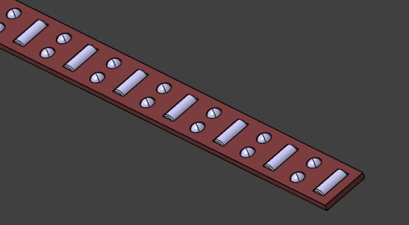

Recently I tried to make a Laminar box that composed several layers. and layers must have moving freedom in X (Longitudinal) direction under load.
to reach this goal I made some Aluminium frames and put flat bearing between layers.
But when I applied load on frames, they Locked and didn't move at all .
why this happend ?
I used surface grinding for roller plates and now Ra is 1.6

Finally I could overcome the problem with these steps :
1) Decrase cylindrical bearings number and replace half of them with ball bearings.
2) Change cage material with Plexiglass.
3) Change design of bearing cage, so the bearings are in middle of cage and they can't pull out their positions while moving.
At the end, I test It under uniform pressure and It worked !
Thank you

unfortunately, I haven't picture right now,but I can share new cage model picture.
