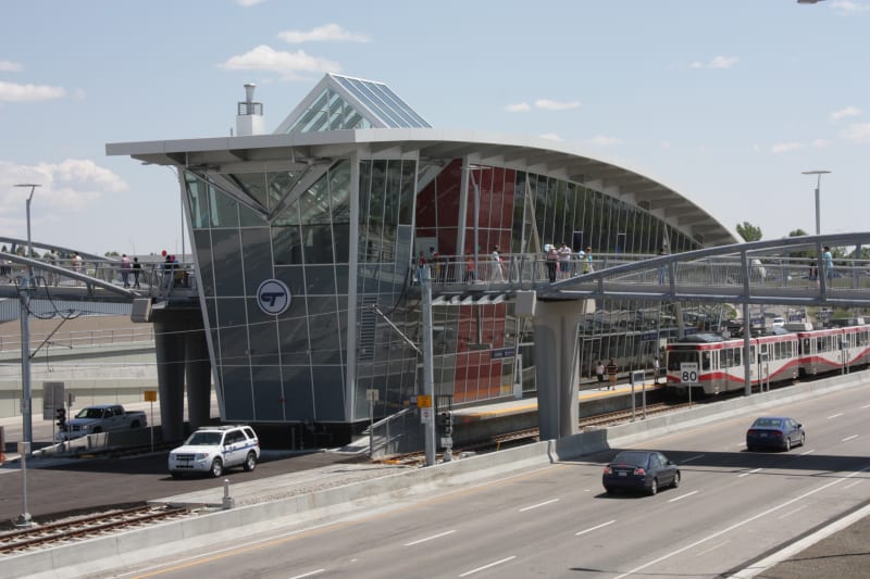

For the structure shown below, which was true deck bending, Canam advised us that it could work so long as it didn't take more than 50 lbs effort per sheet to push the deck down for fastening based on Ix etc. Even that is a a bit uncomfortable in my opinion. At that level of force, I'd have to think you'd be dealing with some substantial residual forces in the deck and fastenings.
If I understood him correctly, he was basically talking about forcing a milti-span deck in the strong axis to an adjacent member that deviates from the deck slope. I vaguely remember him saying something about sledgehammers, so your concerns about the residual tension in the fasteners is probably warranted. My thought is that any concerns with warping in the weak axis should be negligible, I just need to look through the extreme conditions in the strong axis and make sure they’re manageable. It might make sense to just have them use single span deck sheets in some areas to alleviate any induced tension on the fasteners.
On the building in the picture, the deck is spanning parallel to the roof curvature?
It is, bending the deck the hard way. It's another story yet again it's actually two layers of deck for diaphragm reasons which made for lots of fun at the sheet corners where you've got heaps of deck overlapping in one place. Pretty good argument for discrete roof bracing when things get exotic.
