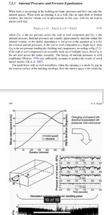

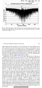

Air only pushes. It cannot pull. Kopp’s partial chapter, that I provided above as a screenshot, addresses how air can get under and push up on layers of roofing.
Open buildings still experience pressure differentials. The eaves aren’t airfoils. Air is incident upon the eaves and rolls over and under the roof, not in equal volume. Vortices are also generated and shed.
Thank you for that explanation. So it is possible that there is no net uplift on roofing materials if there would be a perfect seal in all elements. All of the uplift would be a pushing force from underneath the roof?
Exactly. And in the case of a topping for the purposes of this discussion there wouldn't be an air later between it and the substrate. Sure there might be some trapped bubbles but nothing of consequence.
