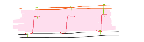

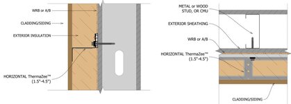

Would a pattern of cold-formed Z sections work, assume would need to be discontinuous for energy, then you could do the shorter Simpson #6X1/2" screws or deeper if needed installed before the insulation making it easy to miss the joints and then whatever fastener you want for the plywood to Z attachment.
i think that the screws or nails shall be to the roof rafters by pywood top and bottom to T&G whith depth of rafter 10" min. 1739475565821.png
Would a pattern of cold-formed Z sections work, assume would need to be discontinuous for energy...
That's got curb appeal. Any idea how one goes about making it discontinuous?
was thinking discontinuous in plan rather than through the depth, so maybe something like 24" long @ 4 ft o.c.
I like Celt's idea, though foam insulation may be needed to make it work.
That would not seem to solve the thermal break thing. What am I missing. There's a specialty product online but it tops out at 4.5".
Is that really something that can be done? Screw through the insulation and self tap into a sheet metal flange below? I'm game if it's possible. I've just never seen it done.
I don't see why not. I haven't seen it done before either, though. The biggest hurdle maybe finding a self taping machine screw for light gauge metal that is long enough to float through the insulation, but at a quick glance the pull out values should be workable depending on your conditions. Wouldn't be a huge fan of this kind of set up if you were putting the screw into a bending, but if uplift is your only concern, I think it makes a lot of sense.
alternatively, maybe something like this?
Riffing of of the detail below, may this is the way to go. Two layers of sheathing with the lowest being connected to the deck boards.
I've never seen it either, but I don't see why not. Your original design is screwing through insulation and into a substrate. This just adds an additional substrate. you may end up needed to do a couple of layers, though - spray foam up to the top of the purlins, then rigid over top to give you a smooth surface for your roof protection board.
Thanks for your contribution @DigiAlmond. With reference to the quoted comment, I've been kind of assuming that we just sort of handwave the tendency for the roofing to shift downslope? I'm sure that rigid insulation is a "ply" in the the NDS connection sense of things. Just a rather difficult one to assess. Probably does a version of strut and tie.
I see your point. With the deck boards as the substrate, that kind of feels like the boards won't try to shift away from the screw like the top flange of a z-girt will. That said, metal roofing gets fastened to z-girts successfully so, clearly, it's possible. Thanks for walking me through it.
That was my assumption. I think if these connections are decently close (which it sounds like they will be) it's probably a wash. But I would probably check with the arch and make sure the insulation on the T&G has some method of attachment to the T&G, for good measure. Doesn't need to be perfect, but it certainly wouldn't hurt to preclude any shifting that might put additional stress on your screws.
As in adhering it? Intuitively, I certainly wouldn't relish the thought of wind gusting underneath it. Granted, that would take a fair bit of separation.

Take look at these two documents on fastening thick claddings to a wood frame. Link1, Link2 They're from Building Science Corp. The second link shows fastening 10" insulation. The first one is some structural research they did on fastening thick claddings.
