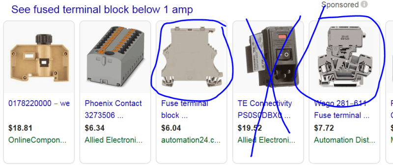

Maybe a PTC resettable fuse i.e. thermistor?

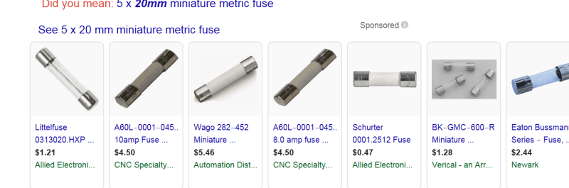

Maybe a fused terminal for each concerned wire?
Just google it. Most automation houses have different manufacturers brands. Fuse size is the problem. I think Littlefuse or allied electronics would have the fuse size of below 1 amp. see below pictures

itsmoked, I couldn't agree more regarding fixing the installation! Unfortunately this is a product we are selling to external integrators so we don't always have control over things like that. Even though this "thermal incident" was very likely the integrator's fault, I'd still prefer our product to at least fail gracefully. That's why I'm looking for a cheap and easy fix, rather than an expensive one such as an isolator.
If no one thinks fuses will cause an impedance issue then I will probably just head down that road. Thank you for your responses!
IRstuff, yes a standard fusing solution would untwist the pair for a good inch or two... What about a thermistor? I would be worried that these have some inductance to them.

A thermistor is probably even worse. You need to just do the proper termination and protection of the shielding; you cannot protect against any and all possible methods that a determined idiot could use to destroy a system.
