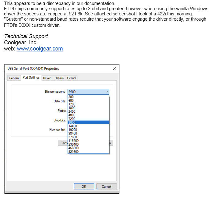

I hadn't seen that before, seemed like a decent option, but after looking into it (you have to go awfully deep to find this!), that model only goes up to 128kbps...
RyreInc,
I noticed the website said the US-422i converter went up to 1Mb, but as you pointed out he PDF said it only goes up to 128Kb. I used the chat button on their website and received this response via email. According to them, their PDF is wrong and the device does actually work at 921,600 Kb/s. Worth giving it a try.
Wow, thank you very much JG2828! Although that doesn't inspire much confidence in Gearmo, does it... but I went ahead and order one (along with three other options) to try anyways - and only $50 on Amazon too.
