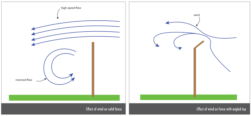

I found this idea online. Would angling the top (see figure below) of the wall with some wood structure or installing a strip of lattice across the top of the wall reduce the turbulence?
I presume that all surfaces inside and outside the fences are sand.
Adding an angled extension or lattice will most likely result in the sand spreading more evenly.
The only way to keep it from dropping all together is to either cause it to drop out before it gets to you, or not cause any eddies where the air slows.
You might also look at snow fence designs, it is the same issue.
If that angled bit was made of the 50# open metal stuff then this might work as the sand would drop on the other side of the fence, or maybe only the top say 75 % of the angled bit was some sort of semi open mesh to allow the sand to fall through. You might even be able to patent it!
assuming the sand moves from one side of the yard to the other side and is not blowing over the fence. modifying the fence might not work, no way to predict if it will, and it could be a waste of time and money. not to mention it may not look attractive. rock mulch is the typical way to stabilize sandy ground and prevent erosion or blowing sand and dust where I live. planting grass requires a lot of water in the desert, better to stick to native plants and cactus
