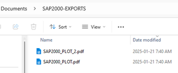

I am tired of the time to enter the plot names for each .pdf file. Using PDFCreator I can dump a plot to a specified folder in seconds, but they are not named. So long as you print them in the order you want, you can bind them into a package easily when you are done. I see there is an option in PDFCreater to add a CSharp script. Is it possilbe to extract the model name and view setting from the model using CSharp and the API interface? Ideally I would like the saved name view titles, but I do not think that is possible.

Hopelessly low tech but my quick and dirty would be:
1) Dump the plots to the same file as the model with no other PDF in there.
2) Copy an excel sheet into the same folder.
3) Write a VBA routine to extract the name of the model and rename all of the PDF's in kind. Maybe with a counter at the end depending on you needs.
4) Just keep using that same XLS over and over. Sure, you could do something fancier that has folder picking from an EXE file or something.
Never mind... I now see that you want to name based on model view names, not model file names. That will be fancier. @Celt83 may be good for this. Hitting the API or scraping the printed PDF's may well be required.
From an API perspective, I don't think there is a current way to get the named views. I do not see any API functions to work with named views, even in the database tables.
