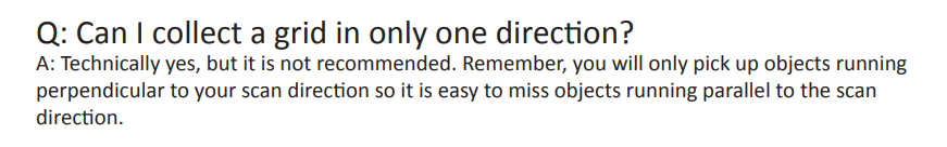

KootK. Can you dig along the side and scan from the side? Typical Foundation NDTs - Non Destructive Testing - "rolls" the scanner around / along the perimeter. Spacing is marked with a grease pen, measured in the field, and confirmed on the computer back in the office once the data is uploaded. Scanning from the top is not possible b/c the scan would hit the "tips" of the longitudinal bars. You need a full surface across the width of the scanner ~8" to identify the change in density btwn the two materials. Hope that helps.

B) GPR reports discontinuities via radio wave bounces and isn't actually "seeing" the rebar. It's rather difficult to distinguish what is what and takes a bit of back and forth (over some length of bar) for the operator to do this reliably. Perhaps the butt ends of rebar will produce only such localized discontinuities that it would be difficult to detect (or impossible to) with the desired degree of reliability.
According to one tech guide you can only pickup items perpendicular to the scan direction, so this seems likely.
