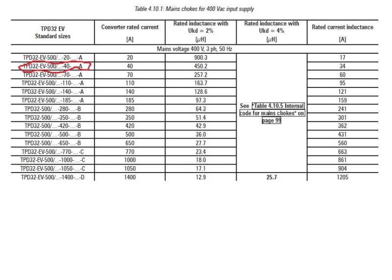

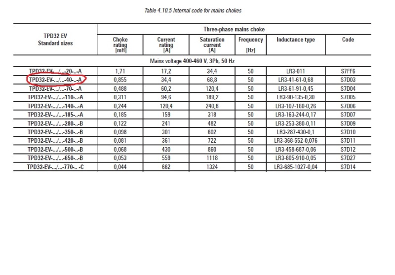

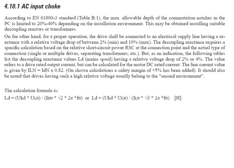

I have the DC Drive TPD32 EV Instruction Manual and this is what I found:

How did you calculate L from 8,5 ohm?
XL=w.L=2 x pi x f x L=2 x 3,1415 x 50 x L
8,5=100 x pi x L
L= 0,027 H
L=27mH
I used a slide ruler. Use your value if you feel more comfortable with it. Any reactor in the right ball-park is better than no reactor at all. You were most unwilling to put any reactor there only yesterday - remember? Use anything that isn't ridiculously small or large.

I wrote to Gefran for a quotation for the reactor code S7D03 . What still puzzles me is why only block 4 keeps falling

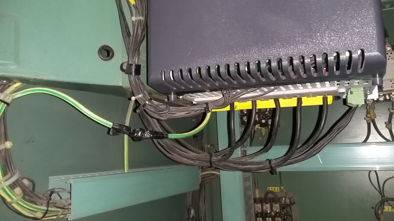

The only suspicious thing that I found different from the other blocks is a joint in the PE cable to the drive. See picture

Need to apply 2-4% factor, so L will be about 0.5 - 1mH.
