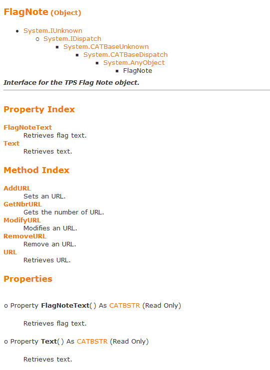

Hi!
I'm fairly new to the enterprise knowledge language, is there a function that is able to search for the flagnotes that are under my annotations in a part and then list them. This could be through the action command. It would be great if this could be incorporated with the "notify" function in order to see all the flagnotes in the corner of the screen as a sort of legend. I am hoping this is not an impossible task.

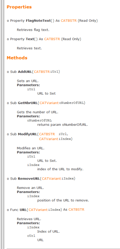

I found the "CATTPSFlagNote" function, however there is not a lot of documentation displaying how to use it. Any help would be greatly appreciated.
Thanks!
I'm not sure if this applies to what you need but there's a .chm file in the install you can reference.
you can search your model for the flag notes: 'Functional Tolerancing & Annotations'.'Flag Note';all
