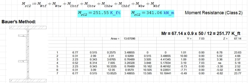

Just finished the SMath program... Calculated Mr is 249 K-ft... and using the summation of the Zx for both the C section and the W section is 254 K-ft... the C section at 44 Grade... about as close as dammit is to swearing... The moment resistance is about 250 K-ft... I never design closer than that anyway...

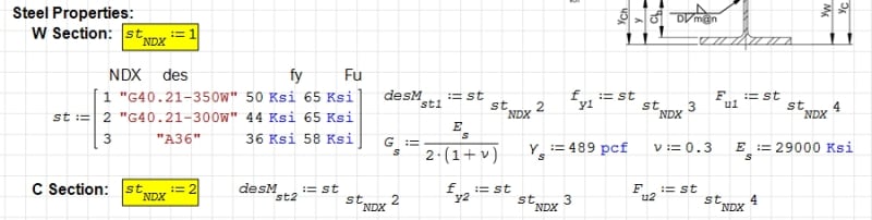

Thanks Celt... that's been done. With programs I usually include different steel types for different elements.

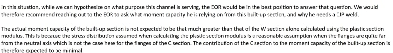

Response from the CISC... No comment on the Class; as noted, the increase is minimal.

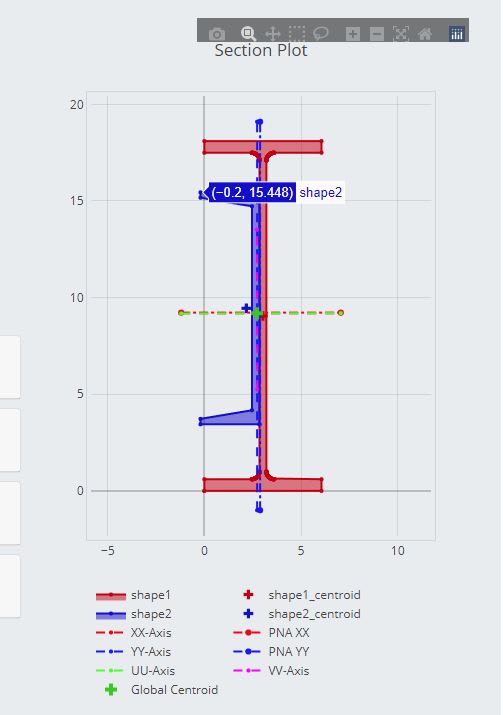

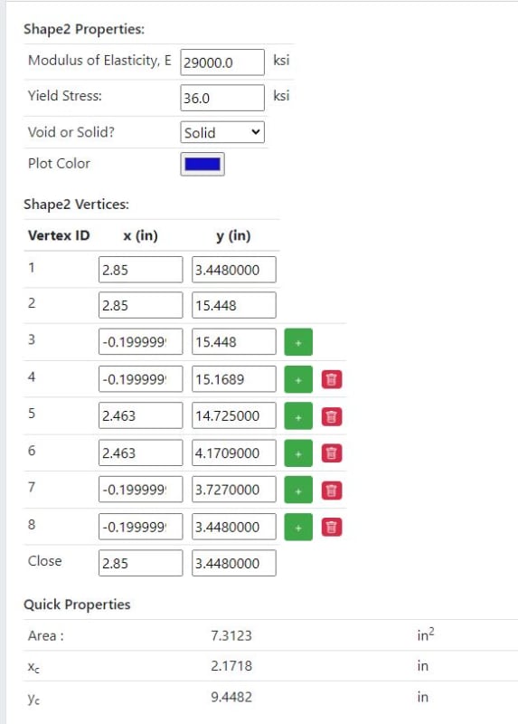

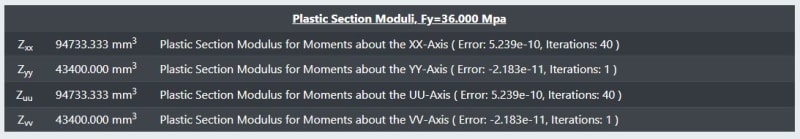

In your spreadsheet it doesn't look like you have accounted for different yield strengths of the shapes. I'll update my site later today to include a shape template for channels not including the fillets based on the attach info, (I should be able to work out the interior fillet from the K dimension but for now the properties are close enough to the manual without it, AISC nor ASTM provides any info on the flange toe fillet anyone know if this info exists?)
Here is what I assumed for the top of the channel inferred from your yn dimension of block 3 in your spreadsheet:
Coordinate information for the Channel (I have a template built for wide flanges that approximates the fillets as several straight sections):
Resulting Properties (note that Z is based on 50 ksi Fy of the Wide Flange and accounts for the channel being 36 ksi):
Composite Section Results

Plastic Section Moduli, Fy=50.000 ksi
Zxx 112.063 in3 Plastic Section Modulus for Moments about the XX-Axis ( Error: 7.206e-09, Iterations: 34 )
Zyy 15.830 in3 Plastic Section Modulus for Moments about the YY-Axis ( Error: -9.789e-09, Iterations: 38 )
Zuu 112.063 in3 Plastic Section Modulus for Moments about the UU-Axis ( Error: -3.038e-10, Iterations: 34 )
Zvv 15.828 in3 Plastic Section Modulus for Moments about the VV-Axis ( Error: -7.119e-09, Iterations: 39 )

I found the Bauer reference on this site... and downloaded the reference... The red notes are my comments... attached
[URL unfurl="true"]https://res.cloudinary.com/engineering-com/image/upload/v1695148074/tips/bauer_1997_plastic_modulus_aisc_00_o538en.pdf[/url]
As far as Bauer's approach... I don't account for the different yields strengths, but in my SMath program, I do... there's a really close correlation between the Bauer and the SMath for steels using the same yield and the SMath accommodates the real difference.
Who uses Grade 36 anymore, maybe for things like plate and BAR stock. The spreadsheet works on areas only and I guess I could try to modify them to acommodate for this using a modified area of some kind... I used the Bauer method just to 'confirm' the SMath output. I just noticed a 'hiccup' in my calcs. With SMath I use fy = 350 MPa and my spreadsheet I use fy = 50 ksi... It makes a bit of a difference. [upsidedown]

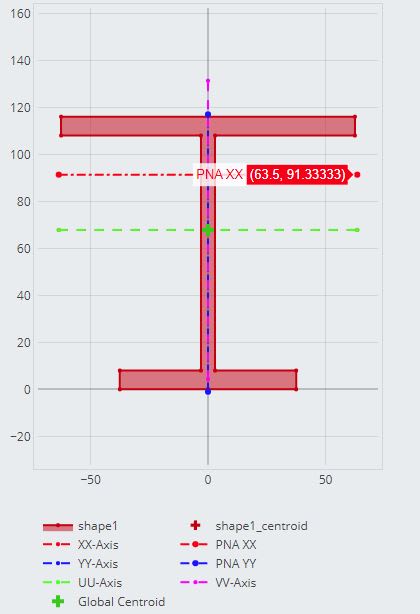

I get good agreement with the example in that document:
y,bar = 116 mm - 91.3333 mm = 24.66667 mm
Same here, but I didn't check their example... compared it to the SMath output... Thanks for the confirmation...

The use of the channel has two effects... The strengthening of the W section is minimal. In addition the EOR has called for a CJP weld of the C section to the W section. This is not only improper, but the limited clearance between the inside of the W beam flange and the C section flange makes it extremely difficult to weld...
